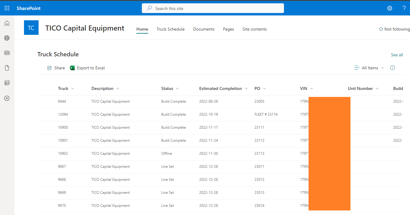

So, we are (roughly) our second-largest customer, which is why my company’s name is on there. But imagine this being some customer’s name
The grid is a SharePoint List - you have to know that term, “List.” It’s SP’s term for “a table with data in it.”

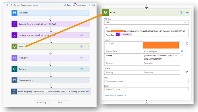

The list is populated every 3 hours via a Flow (Power Automate). The magic here is the HTTP step, which is a REST call to Epicor.

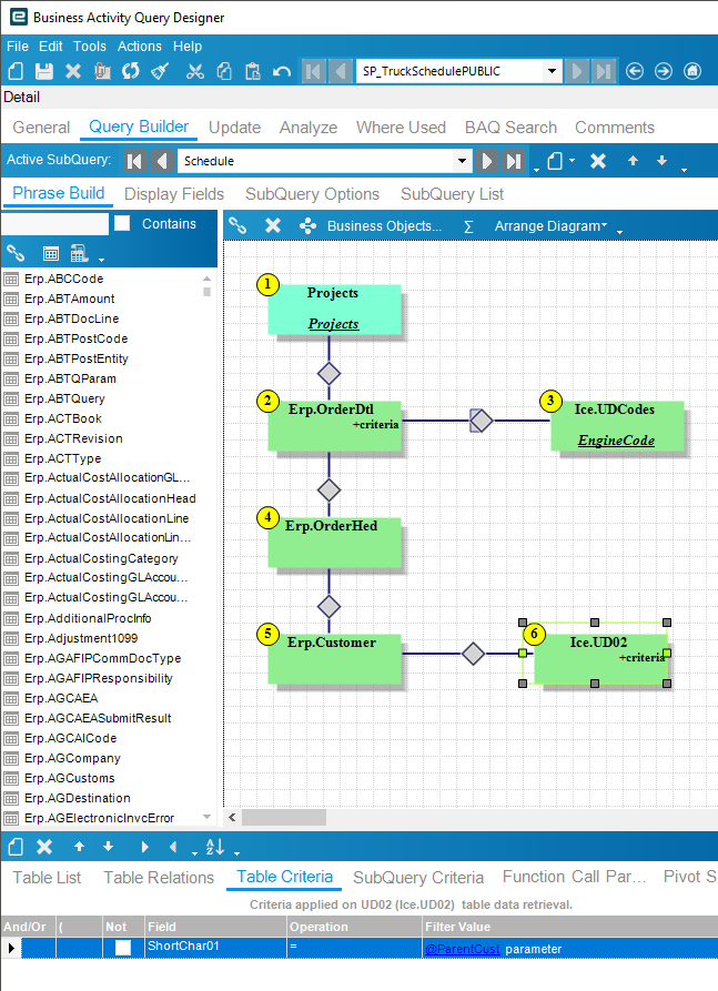

And the basis of it is just a BAQ. I used a parameter. Also I got fancy and used UD02 as a lookup table for “parent customers.” Reason is that we have “dealers” that might encompass 2-4 legal entities in our system. Or two of them merged or whatever.

Free advice: for about 10,000 reasons, you MUST become a whiz with BAQs to be successful in your implementation - and I am not meaning just some SharePoint integration; I mean for the whole Epicor go-live and daily use.
