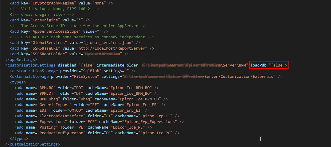

If you output pdbs (setup in appserver config file) you can live debug the appserver. It will stop all processing in IIS app server though so you can only do it on dev systems no one else is using.
Thanks for the input. Can you point me in the right direction to make the changes you suggested?
This is a dev server.
In your app server inetpub folder update web.config set this to true. You can then attach your visual studio instance to the appserver need to have it installed on the server or setup remote debugging. It’s a process but can be very rewarding. I don’t have detailed instructions on hand and it’s friday I’ll circle back next week lol
