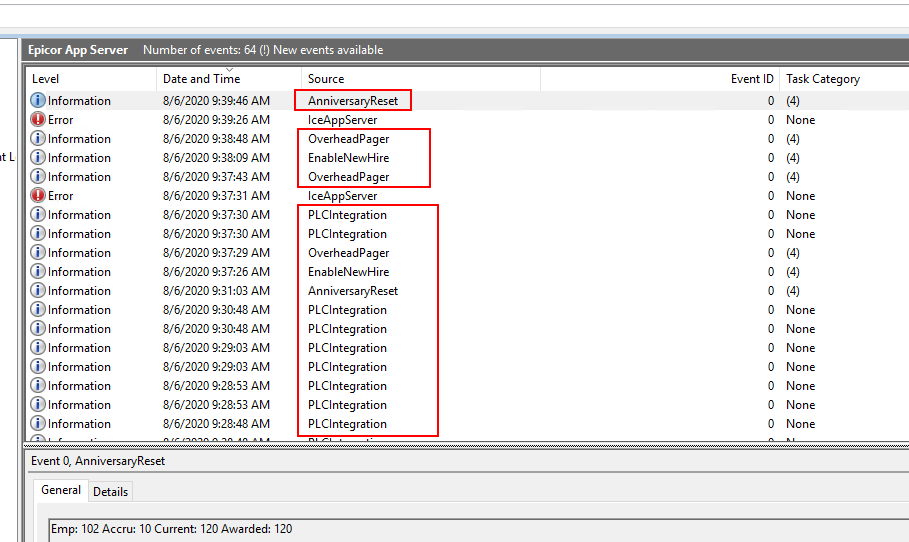

To help me perpetually with troubleshooting I added a function library whose sole purpose is to write to the event viewer with more detailed information. A step past debugging. Not your standard Ice Exception source. The Task category corresponds to a UBAQ, Method Dir, Data Dir, Efx, or straight rest.
That’s slick
