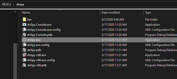

This uses DNSpy do you have that installed? I recommend you try the built in debugging in regular customization mine uses reflection and it is better (if you are able to) to use the Built In Customization Debugger that Epicor has.
Write the code using visual studio, sync it and run it then debug it using the native tools.
If you can’t do that for some reason then mine will work but it requires an external application called DNSpy to be setup and configured correctly.

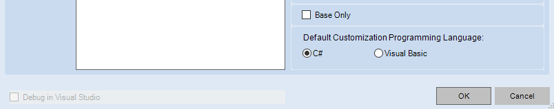

Run your customization normally from Epicor and click the Debug in Visual Studio CheckBOx bottom right of the Customization Selection Screen.
(From Epicor not from Visual Studio)
According to EpicCare the issue is they are not detecting the VS install and you need to check this article for where the registry key should be. I am also using 2019 Community on several machines.
