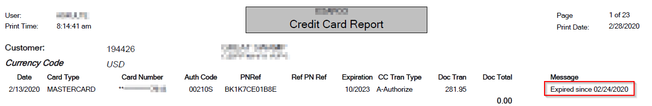

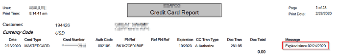

Where does the base SSRS Credit Card Report gets the “Expired since ##/##/####” message for the pre-authorizations?
The CreditTran.ResponseMsg has “Approved” stored, not “Expired since”…
Here’s what our Reporting Manager found when he dug into it:
The report named ‘CreditCardRpt.rdl’ references the ResponseMsg field. When looking at the Report Data Definition for the report ‘CCRpt’ and the dataset properties of the report I see that the report is referencing the ‘ResponseMsg’ field from the CreditTran table. When I run a sql query against this table looking for the PNRef in the example below that field =’Approved’, not ‘ Expired since 2/24/2020’ as in the report.
