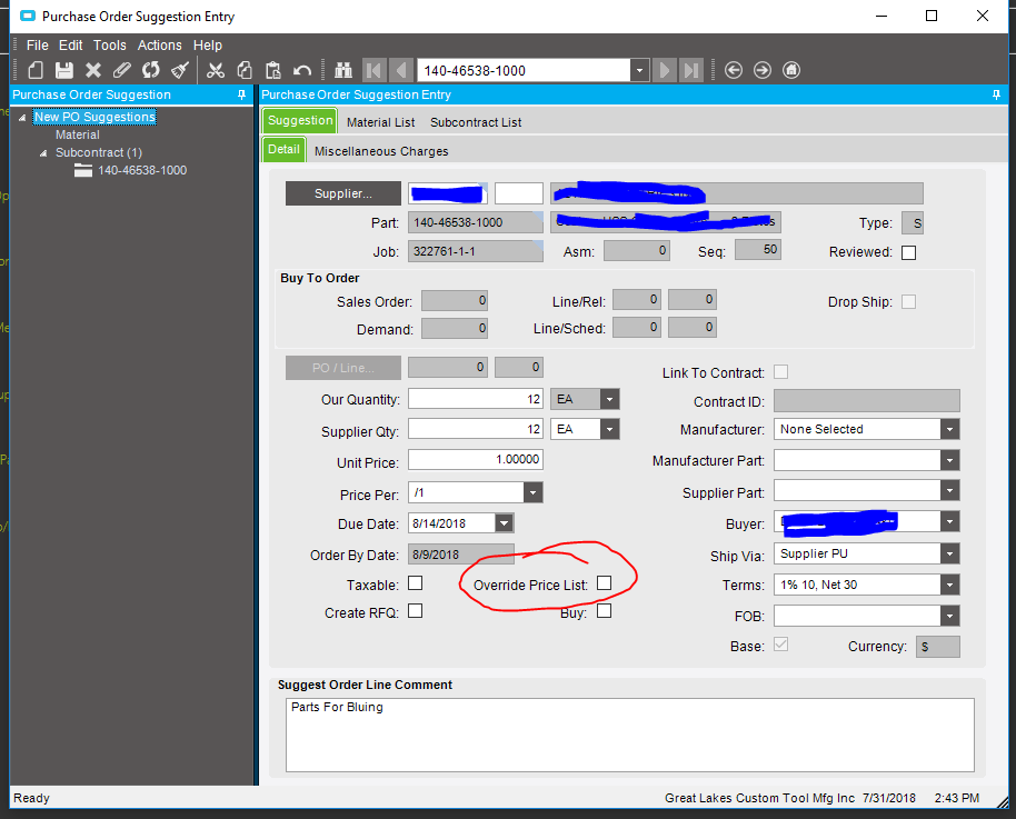

When creating a PO, we have a post directive that runs on PO.GetNewPODetail which sets OverridePriceList = true. This works fine.
However, when creating POs through generate po suggestions, I cannot get this checkbox to default to checked.
I currently have the post directive running on POSugg.Generate, but the checkbox doesn’t default to checked when viewing in PO Entry.
Thoughts?

What I need to figure out is how to have this checkbox defaulted to checked.

Adam - Did you ever figure this out as I am trying to do the same. Thanks!

Me three, I also am seeing a problem with this. Has anyone out there ever managed to default this field when creating POsuggestions
