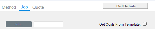

It seems like I need a part number to create a template job. Is there a way to create a template job that can apply to any part number?
Yes. Notice when you bring up the Get Details form, there are tabs for a Part Method, a Job, or a Quote. If the job is marked as a template, you can enter the Job Number here.
It doesn’t matter what the part number is on the template, it will copy the operations and materials from the source to this job.
Very cool! So I created a generic part called NOPART. Then I created a job for that part called TEMPLATEJOB. Now I can reference that job whenever I want to create new job and pull in the defaults. Neato! Thanks all!
