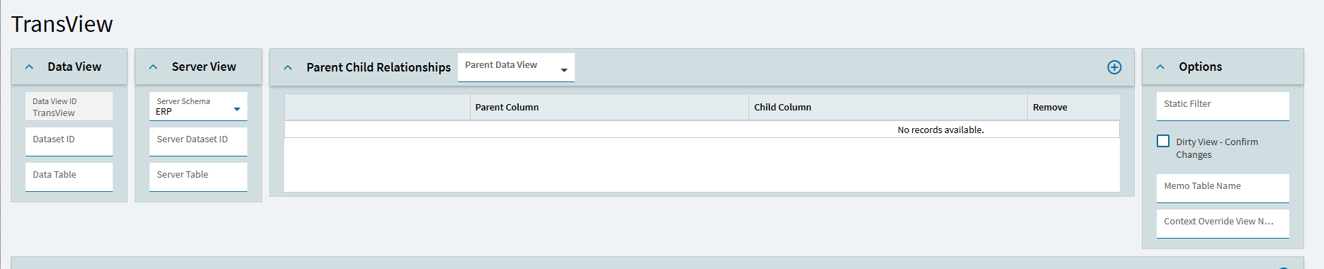

If you are starting with a blank dashboard and you have a BAQ that returns a lot of data and you want to filter it by a date range by default onload so it actually gives you a smaller load footprint, first you need to set up a TransView DataView. I’m pretty sure all you have to do is literally just put in the Data View ID

Use TransView as the DataView. Click the pencil and add the following as an example.
