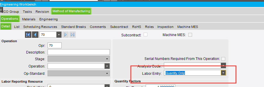

Defaulting Labor Entry to Quantity Only
Is this a configuration somewhere i cant find, or do we need a BPM?
I want the default set to Quantity only when i add an operation.

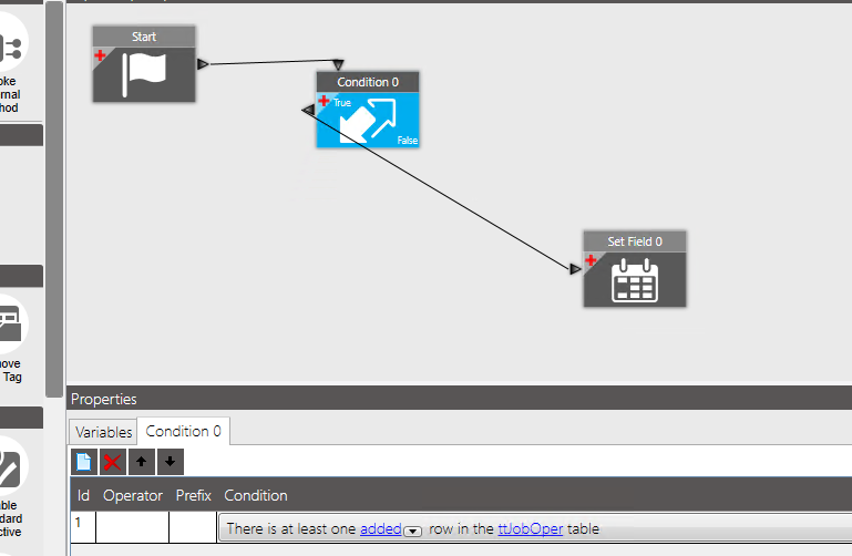

It will be BPM that you will need when you add an operation if you are doing this in both engineering workbench or job entry then you will need multiple bpms. You will also need to set the employees who clock this off to report quantity only and also enable the report quantity button and also train the employees on how to report quantity ie don’t start production/stop production, just report the quantity.
If the added op is not the last op on the assembly then you can set to backflush rather than quantity only and you will not need to log anything for that op - key point this will only work if there is another op on the same assembly.
Thanks, created some DD on ECOOpr and JobOper.
