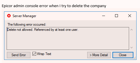

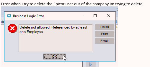

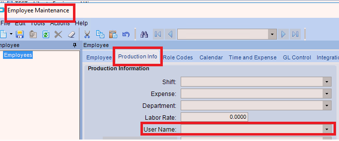

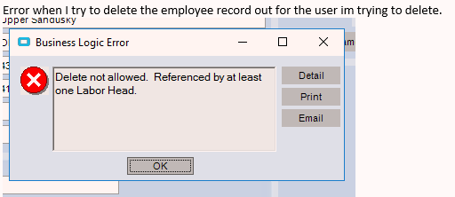

I’m running into a problem that is preventing me from deleting a company. When I try to delete the company out via the admin console, I am getting the ‘Delete not allowed. Referenced by at least one user’ error(First screenshot). Some users have employee records, which have Labor Head records, both are preventing me from deleting the user out of the company to then proceed to delete the company out of the database(2nd and 3rd screenshots). I ran the labor purge process but I can only delete those out prior to18 months from today’s date which didn’t really help me because we still have labor records from 2020 in the database. We’ve got about 30 epicor users that are tied to employee records in the company we are trying to delete, other than manually going in one by one to delete out everything per user, is there another quick way of deleting the users and employee records with labor head records out to then delete the company?
Thanks for any ideas and help!
