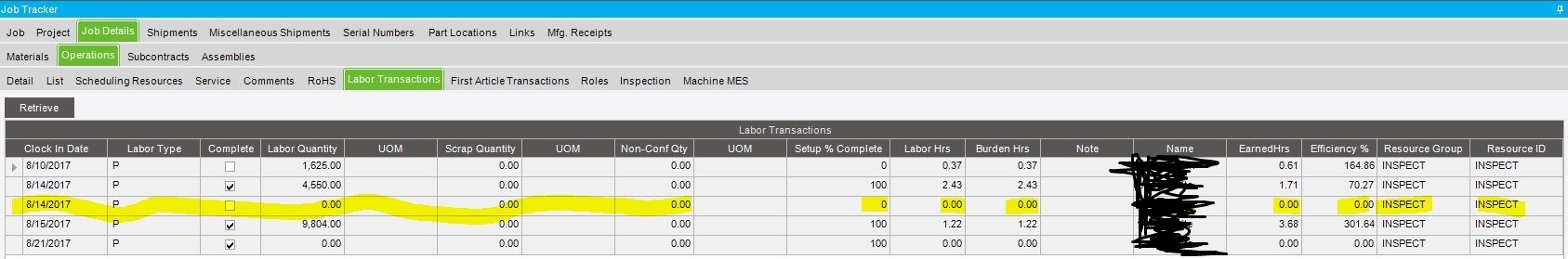

I have an labor transaction in Job tracker that I need to delete. How do i do that?
You can use Time and Expense entry to modify your labor transactions.
Jut noticed that line is not mentioned in time and expense. It appears the worker clocked in 15 min till time to go home, but didn’t clock out as it shows a clock out time of 24:00. Then came in the next day, clocked in and finished the job. But that line still shows its active.

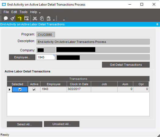

You may have to run conversions 1130 and 1160 from the conversion workbench.
I found the workbench, but how do i run the process? Never had to do this before.
Checkmark the box that says Exec next to the conversion you want to run, then go to Actions --> Run Pending Conversions.
Alright did that, submitted it to run, and the task manager showed it was done almost immediately. And when I went back to look, it did not change anything at all.
actually, it shows up as with the Active Trans checkbox unchecked, that’s a good change.
Now you should be able to edit the transaction in T&E.
