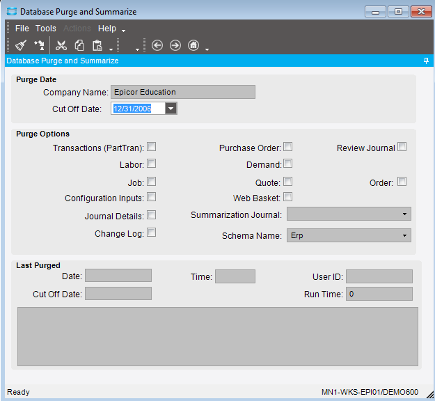

Doesn’t the database purge/summarizing archive the entire database?
Is there a way to just archive the change log records?
The screen has purge options and dates to provide control over what is purged.
