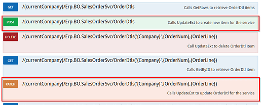

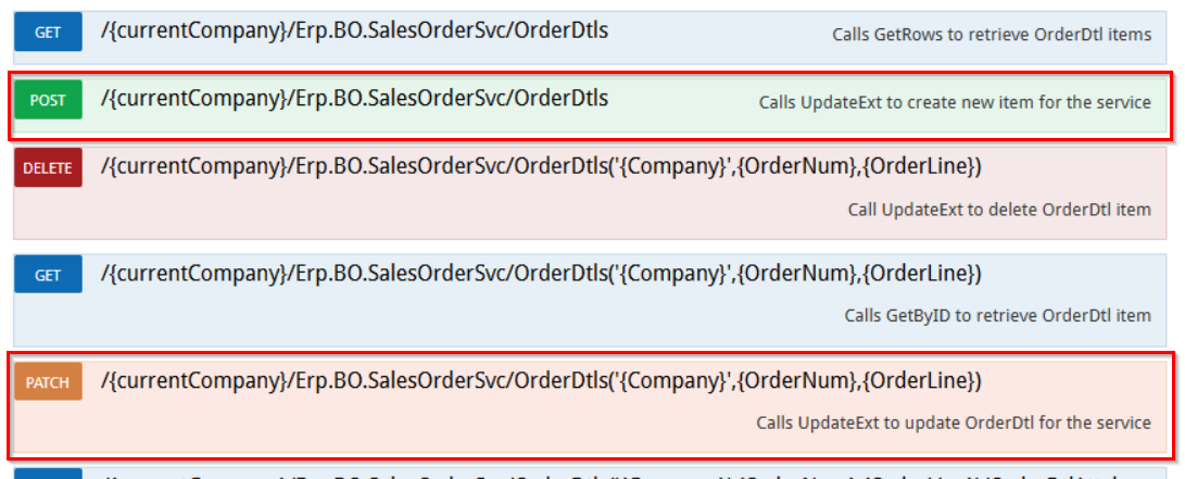

Fairly sure you need PATCH for update items not POST.
POST would normally create new lines.

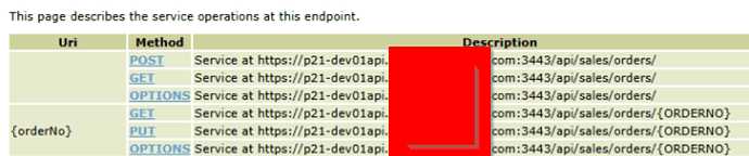

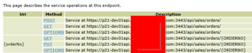

@CSmith Thanks for the prompt response Clint !
Unfortunately, PATCH is not available via the entity API. I have tried using the PUT, but that does not appear to delete or allow modifications of the <Lines> or <OrderLine>s.
