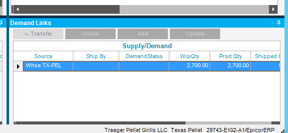

Hello! I’m trying to reverse a kanban receipt and have the following instructions:
Go to “Job closing” and uncheck closed and complete for the Kan Ban job being adjusted.
Go to “Job receipt to inventory” and negative receive the entire qty out of inventory.
Go to “Time and expense entry” and look up the employee number that performed the initial Kanban receipt.
Locate the specific entry for the Kanban job and click recall
Delete the time and expense record for the job.
Go to “Job entry” and delete the stock demand link from the job.
Go to “Job closing” and verify that all the qty show 0 the check complete and closed then save.
I’m stuck on step 6. Where do I delete the stock demand link? Here in the red box?
if so i cannot delete the link.
Does anyone have any idea how to finish this process?

The option to unlink this is grayed out:

mmmm… i’m trying to remember what causes that condition?
can you UN-RELEASE the job?
jgehling
(Jeff Gehling)
September 25, 2019, 8:14pm
5
I went ahead and un-released the job, and it is still grayed out.

fudge
wait that is the DEMAND LINK side.
Can you try to unlink from the SUPPLY LINK side?
its been a while since I’ve been in the mfg side
jgehling
(Jeff Gehling)
September 25, 2019, 8:20pm
7
That option I could click, but it does not appear to do anything.

You have to have at least one demand link on a Job - that’s what drives the Job Qty. It would probably let you delete that one, if you add another one first…
With all the steps you’ve already completed, you’ve reversed any labour and stock figures - the demand link isn’t causing any problems is it, just close the job again as is and it won’t therefore be driving any demand or wrongly showing that it will “supply” anything.

If you just close it, why do you need to delete it?

Thanks guys, I’m just trying to follow the instructions given to me lol I’m not sure! But yes, we did a negative receipt and removed all time and expense.
