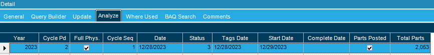

I’m setting up Cycle Counts, and I have a Physical Count that was performed in 2023, posted, but never completed / closed. The problem is… That Count Cycle isn’t showing up in Count Cycle Maintenance. I think someone might have deleted it, and Epicor allowed it for some reason? There is a CCHdr record, which is where I found it.
Am I looking in the wrong place? Just need to mark that as complete and I should be good to go.
If you are using Kinetic screen, it doesn’t display physical inventories by default. You have to search for them and make sure to check the “physical inventory” check box.
Similarly, searching in classic requires using that check box as well.

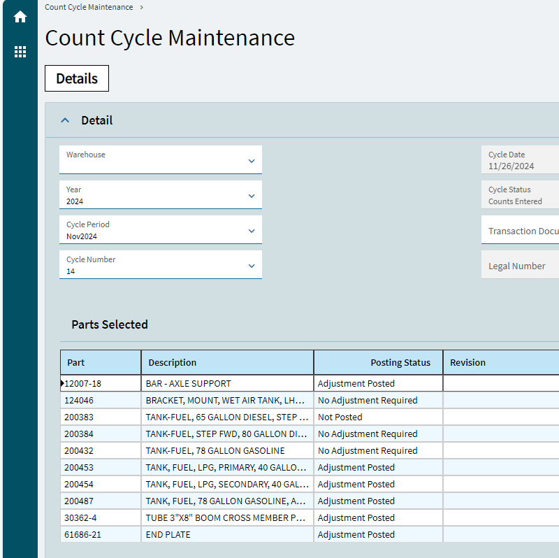

What does the “Posting Status” column look like for this count? Like @lindsayc said, you have to check a stupid box in the search to get it to come up.
Any of the parts say “Not posted”?
Yeah took some digging but there was one part (out of 7k) that wasn’t posted. It was marked as returned and that was throwing me for a bit, but I found the answer to that one here Physical Inventory Not Yet Evaluated Issue - #6 by CyndieC
