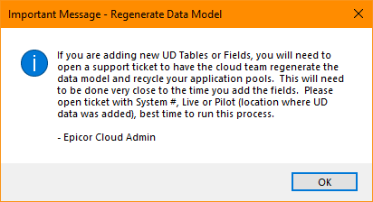

The UD fields get added and removed by Epicor support.
