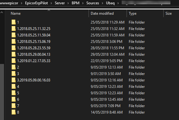

Are the related sub-folders in the server\BPM\sources\uBAQ folder for that BAQ supposed to be deleted when you delete the associated uBAQ?
What are the implications of the specific folder having mulitple sub-folders (I’m assuming is caused by regenerating or making changes to the BAQ methods)?
That’s just the source code where it goes temporarily during compiling.
Having a zillion folders or files there affects nothing a deleting the ubaq will not clean that up

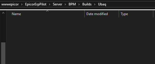

Sorry just to clarify, are you saying when you click enabled on the BPM and save it should store files in the Builds folder? Do they exist in perpetuity?
