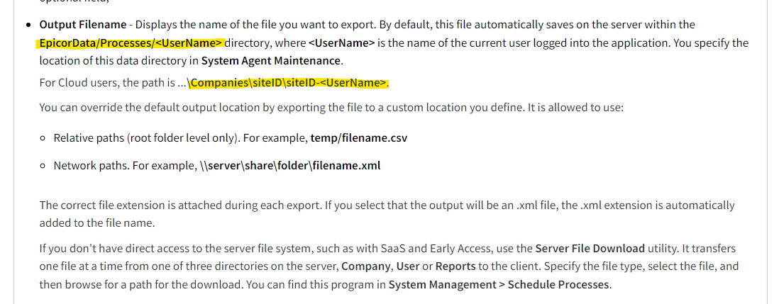

Can anyone please help demystify the relative path story for public cloud?
The documentation doesn’t seem correct.
I go to BAQ Export, choose a BAQ, put Temp\test.csv for output filename and sysmon show success to here:
C:\epi\storage\epicordata\{SiteID}\Companies\{SiteID}\Processes\{UserName}\Temp\Test.csv
Yet when I got to Sever File Download, Choose Type: User, expand folder Temp, I don’t see the file.
System Agent has this path:
*C:\epi\storage\epicordata*
None of this exactly aligns to the docs:
Why would the default User root path differ between BAQ export and File Download?
I think I need to understand how to determine or configure the correct root paths for each DocType: Company, User, Reports, Admin.
Thanks in advance.
