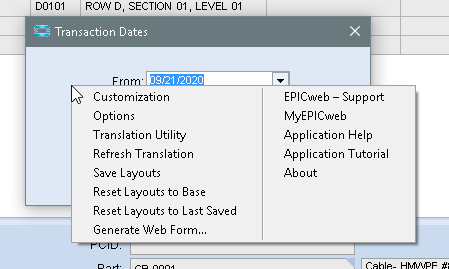

On forms without a menubar, you can right click in the form.
(obviously make sure you’re in developer mode before launching the form)

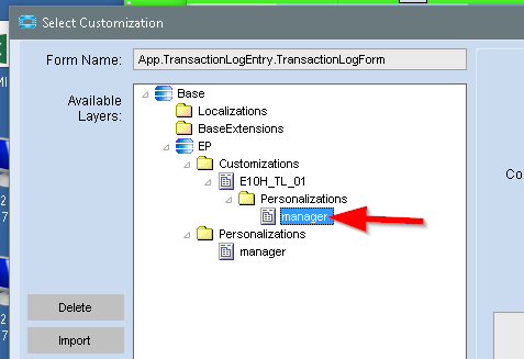

  1. Make A customization of the form. Customize it and set it on the menu maintenence.
  2. While not in developer mode, launch that form. The customized version should appear.
  3. Personalize the Custom form and Save Layouts.
  4. Close the form
  5. Re-enable Developer mode.
  6. Relaunch the Form.
  7. When the “Select Customization” window pops up, select the personalized version of the Customization:
  8. Enter Customization mode on the form, and Save as a New Customization.
  9. Update the Menu Maint to use the new customization.
What I believe that does is makes the second customization use the combo of the first Customization and any changes from the personalization, as the base for it’s customization.
