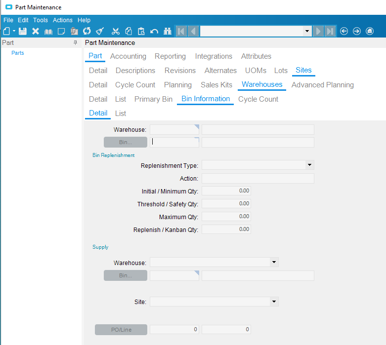

Kanban settings are here (table is PartBinInfo, I think):
So you can get super picky about “if bin A is low, pull from bin B; if bin B is low, pull from C; if C is low, buy or make more, etc.”
You can also do this at the “Detail” tab on the 4th row in the pic (I’m showing the 5th row in the pic). I found that frustrating, personally, but regardless, don’t put settings on both for the same part. Use one or the other.

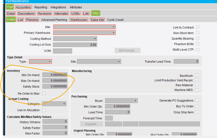

An unresolved question is how it differs from the ROP feature in the figure below.
Those are MRP settings and not Kanban settings.
MRP is simpler/cruder. MRP looks at the whole site’s OH qty and gives suggestions to buy or make more. Then it’s your people’s jobs to find a place for it when it arrives.
Kanban is micromanaging. You can say down to a warehouse or bin what should happen.

What I’m leading to here is what’s called the Material Queue in Epicor. If you have Kanban set up (meaning these PartBinInfo settings in Part Maintenance), then a shipment (for example) will reduce the OH qty in a bin (#2) below THAT BIN’s minimum OH, which creates a Mtl Queue record saying to move material out of its supply source (say #3), and when that gets low, another move is suggested from 4 to 3, maybe, and then maybe you say the supply source of bin #4 is to add a release to an existing PO that you set up ahead of time. Or Kanban can actually make jobs to make the part.
