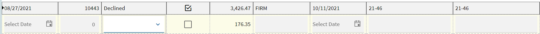

If I will select anything in column number 3 (drop down) then my event is triggered, it call function which is saving data, then I am refreshing dataview. But my row looks like at the image below:
If I will exit edit mode by clicking in other place then my “data” is visible again.

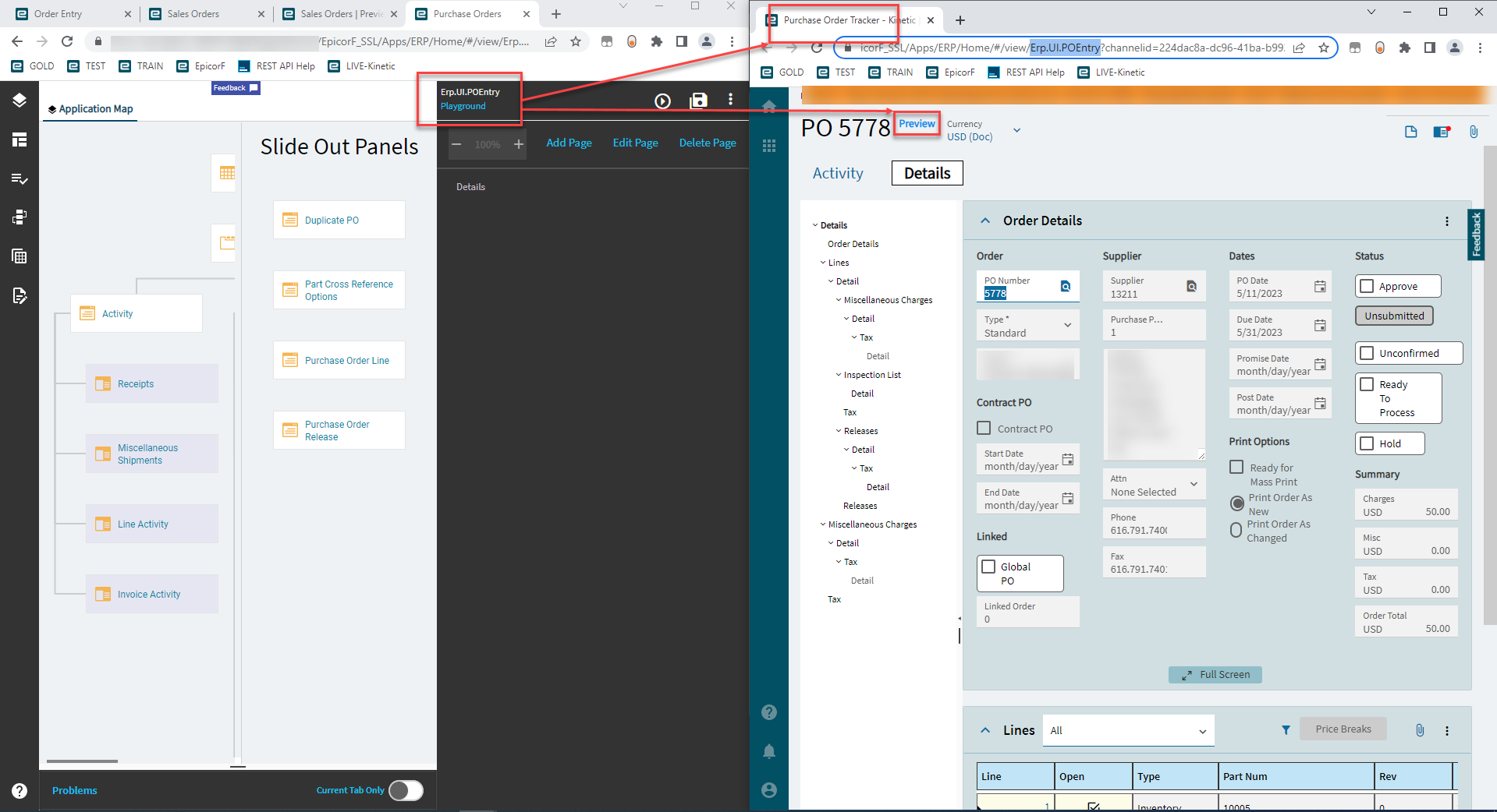

Preview from App Studio? All of a sudden, it’s a tracker. Sooooooo, I can’t test anything.
