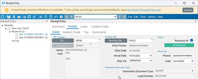

This is the header of my purchase order receipt:

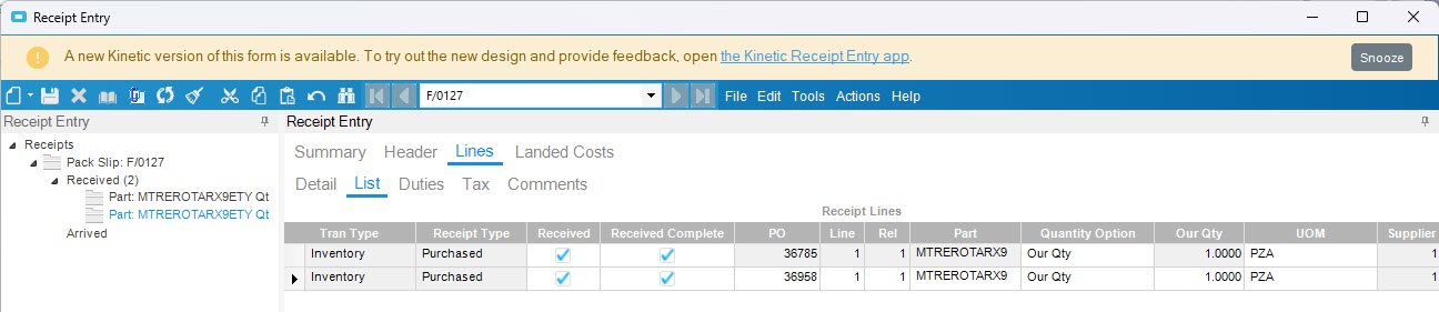

And this is the detail:
Is it correct for the system to allow receiving more than one purchase order in the same receipt note, even when the header of the receipt is directly related to a single purchase order?
Yes, the system will allow you to receive lines from more than one PO. Whether you do is either your company policy/training or if not you could create a BPM to prevent.
You might want to allow multiple PO on one receiving pack slip if, for example, your supplier ships items from more than one PO on a single pack list, your pack then aligns with the supplier pack list. I’m a big fan of “tell the system what you are actually doing, when you actually do it”. If it physically arrives that way, put it into Epicor that way.
