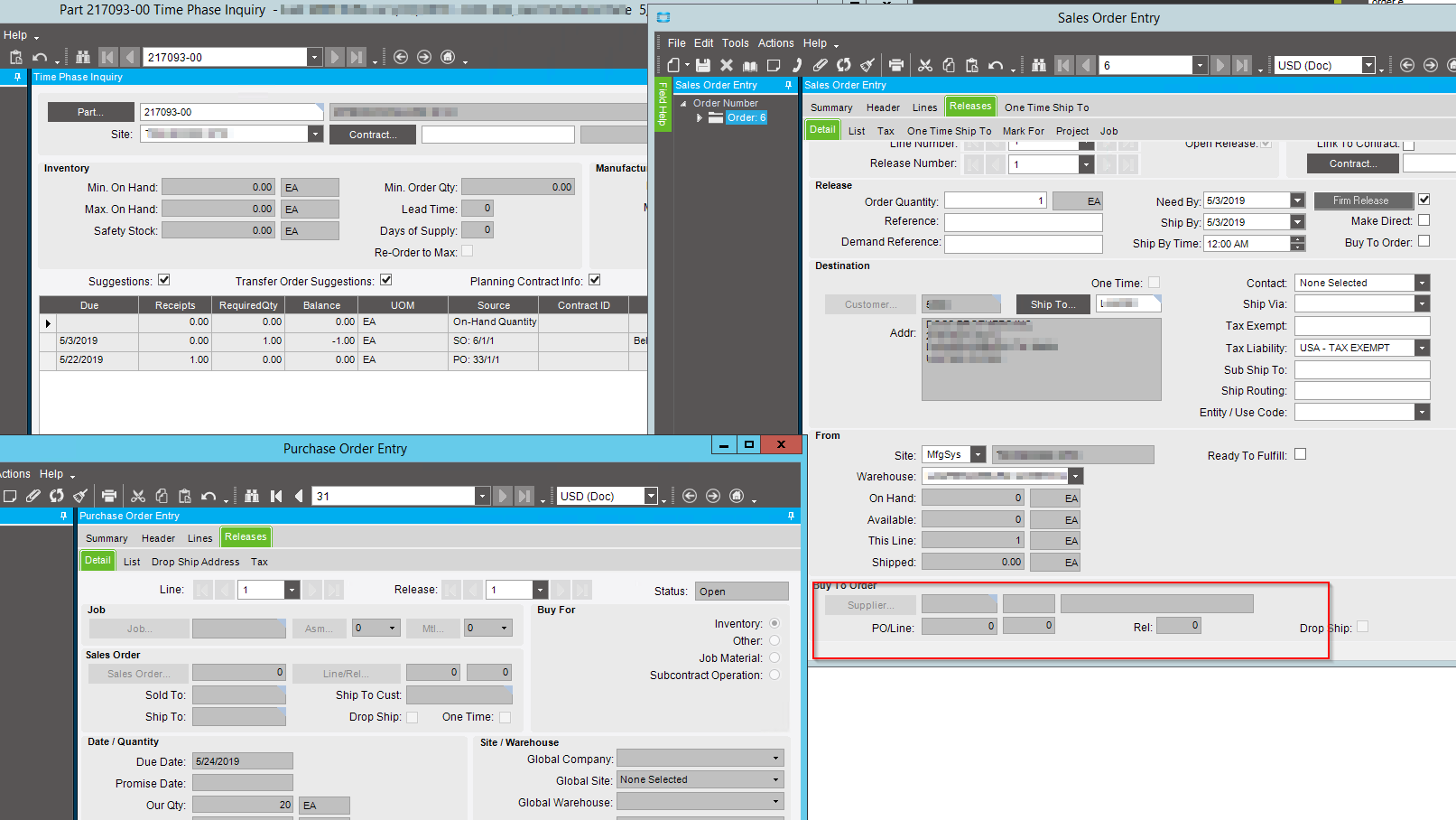

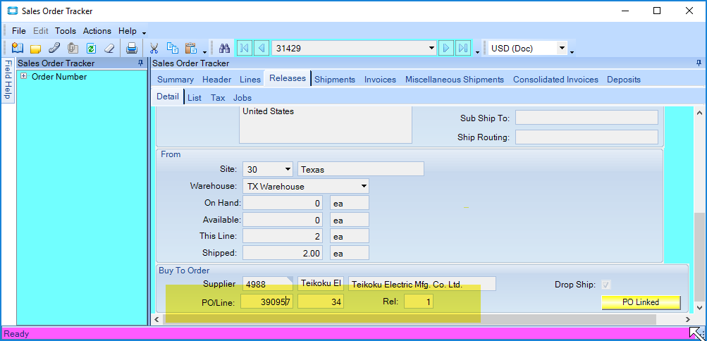

How about the buy to order OrderRel.PONum, line, release data?
Nancy
I am guessing that due to the way the customer processes their orders, this is unavailable to me :frowning:
It seems like this requires Buy To Order, but (for some reason I dont know yet) the customer does NOT want to use Buy To Order.
The SO isn’t Buy to Order, so there’s no direct connection between the SO and PO, just the indirect demand connection from driving stock negative.
