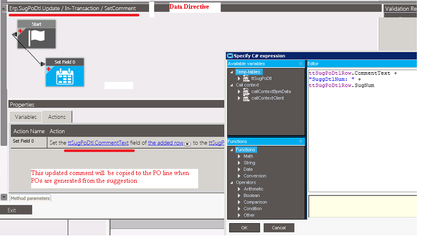

Now I remember…
I used the standard comment field instead of a UD field.
Data Directive InTrans for the SuggPoDtl table
  • for added rows - I set field CommentText.
The updated comment is automatically copied over to the PO Detail comment when the PO is generated from the suggestion.
Your mileage may vary… depending on how your comments look/are used.
Ref screen shot…
So does Epicor automatically copy the SugPoDtl.CommentText to PODetail.CommentText?
Yes…
Note the expression in the previous screen shot
It “should” preserve any existing comment and only append the SugPODtl stufft.
But… you’ll probably want to try this in your test system first to verify it does what you want.

It didn’t work when I used “added row”, but when I set it to “updated row”, it worked! Thank you, this will at least tell us whether a PO was generated from a suggestion.
You might want to do both?
  • Added Row should work when your process initially generates the suggestions
  • Updated Row should work when you edit existing suggestions thru the entry from
