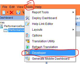

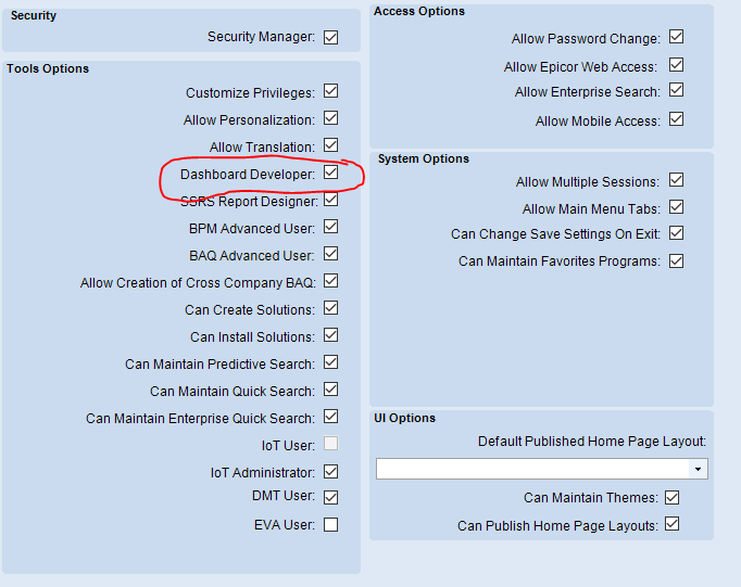

In your user account settings (I think only Security Managers can access User Account Settings), there is a checkbox for Dashboard Developer. Can you have a security manager make sure that is checked? At least that is how it looks for us (we are Public Cloud).
My Epicor manager gave me Security Manager rights which allows me to view System Setup > Security Maintenance. Unfortunately I do not see the Tool option in the menu bar… Is there another Permission type I need?

Run time - which is like running an interpreted program like BASIC. If you have dashboard developer rights, you can select the Developer mode as shwon in @BKen 's post
Assembly (or deployed) - this is a “compiled” version. If the tools menu doesn’t look like the one in @BKen 's post, you’re in a dashboard assembly. You can customize this compiled program if your user has “Customization Privileges”. But to edit the “dashboard”, you want to do that to the “run time” version.

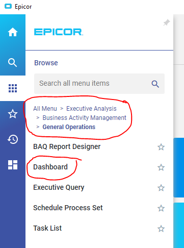

If you’re making a new Dashboard, start by launching the “Dashboard” program.
If you’re changing a dashboard, you probably want to change the “run time” version. Load the dashboard program (see pict below). Then load the dashbaords ID.

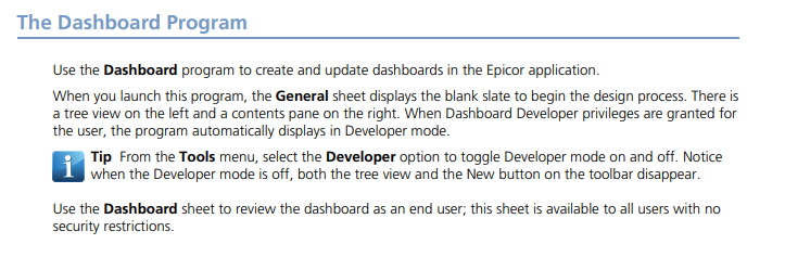

I do not have an option to open Dashboard from Epicor on my computer. We are running 10.2 on prem and I only see the instances we have configured which involve test environments and our live environment. I have the user guide pulled up for Epicor Dashboards and its asking me to visit:
Now, what I am trying to accomplish are dashboards used for gathering reports on our products/scrap through the Epicor system. If the above picture attached is not the correct documentation please let me know.

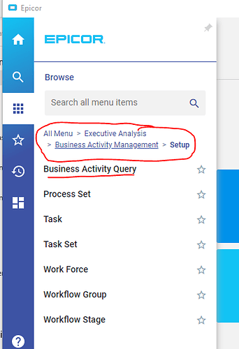

A dashboard needs a BAQ (Business Activity Query - basically the thing that extracts data from the Epicor system). A dashboard is just a UI wrapped around the BAQ’s output. Have you made your BAQ yet?

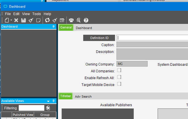

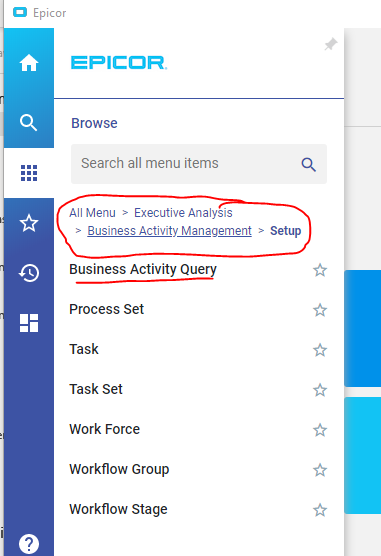

According to the documentation I have to create a Dashboard first then I can start new new Query to add in BAQ’s. Attached is the image specifying after a dashboard is created:
Now as for your last previous screen shot I am concerned that I do not have the Dashboard app installed. What is the default icon location for Epicor Dashboard?
