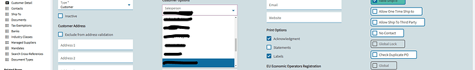

Developers/Code Jockeys: How do we expand this drop down (In Time Entry - see pict.)
All,

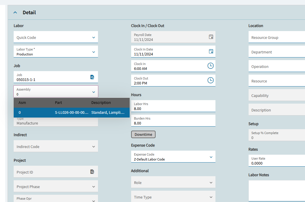

This is the first time we have had the need to expand a returned drop-down list. This is in Time Entry: Many of our Parts have a long list of Assemblies and Operations. We need to expand the width of this drop-down so we can read more of the part and description…
Our Plant Supervisor(s) have requested to see if we can expand these two drop-downs to be able to see more of the part and the description. Our In-House Dev. cannot find anywhere to do this inside Application Studio. z
Please see the attached Pict.
Can anyone point us as to where to look? Thanks in Advance

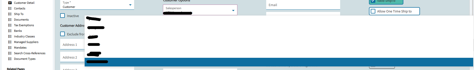

In App Studio, in the Reusable Combo settings… you can add columns and then define their width:
Below is just the standard “Sales Rep Combo” on Customer… which typically returns the Salesperson name.

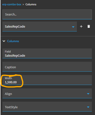

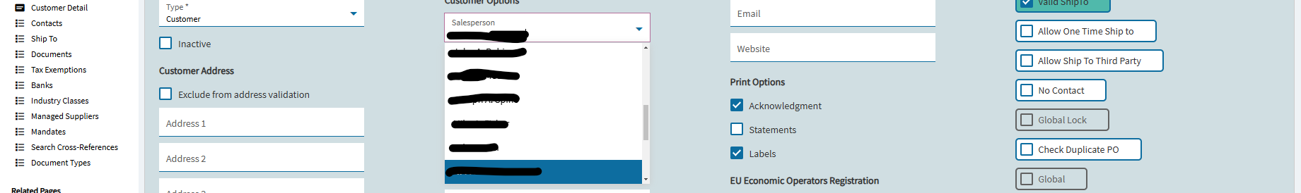

But, in Columns, i can change that to SalesRepCode… and blast it out to 1500 width…
Reusable Combo > Advanced > Columns:
BEFORE:
AFTER:

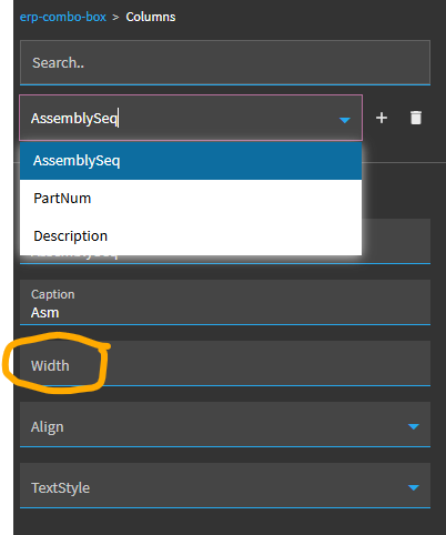

Figured I should look at YOUR specific dropdown… in that case, the columns are already in there.
Just play with the width settings and fine tune to your liking.

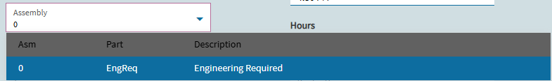

The below example, I set “Description” to Width of 500:
Thanks, I’m not sure how he missed that, but thankfully this is a simple fix! Thanks to all.
