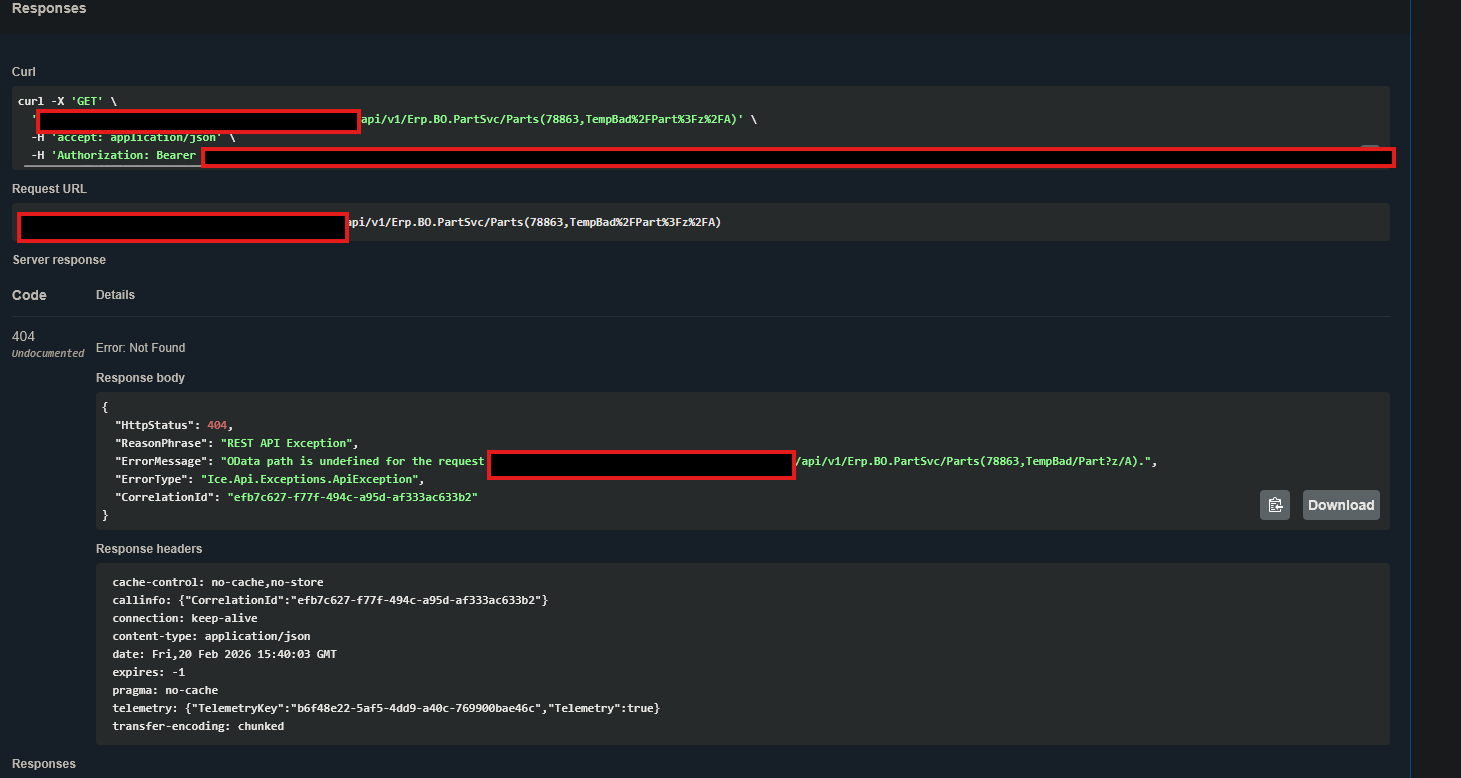

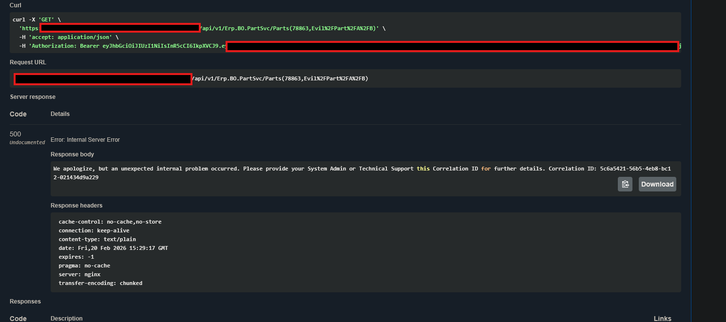

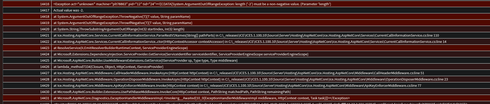

They said last night they’ll be writing up a PRB for development to look at. It’s super easy to replicate - just hit the Erp.BO.PartSvc/Part OData endpoint with a part# that contains a slash. My real curiosity is if this is isolated to us, or if it affects everyone. We’re on 12.1.100.10.
I am surprised if it ever worked. / Usually indicates part of the path in the URL
You can see in his screenshots its being escaped as %2F so I wonder if that is really the root of the issue.

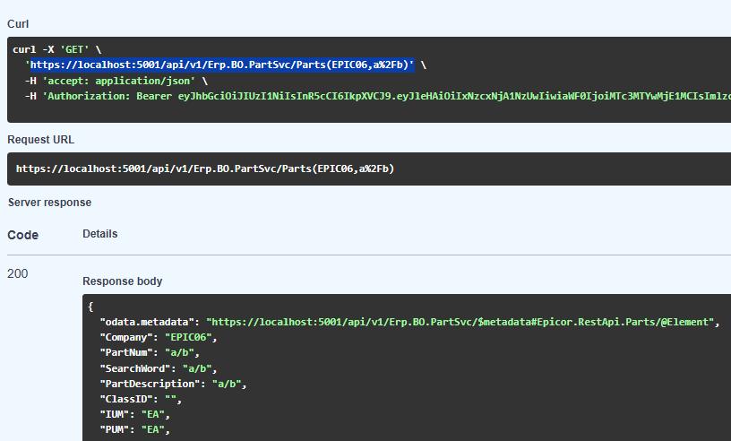

So I think its a setup issue on your side… or maybe that ole Linux thing. It works fine for me in 2025.2.12 (12.1.100.12) (on windows)

That’s not the same call I’m making. You’re calling GetByID. Try calling Erp.BO.PartSvc/Part(companyID, partNum). v1 or v2 doesn’t seem to matter.
Oh, my bad. Yes the OData does give an error:

Can one of you post your RESPOSE headers from the calls. See if we can determine if Linux is being run through KESTREL or via reverse proxy?
 cache-control: no-cache,no-store
 connection: keep-alive
 content-type: text/plain
 date: Fri,20 Feb 2026 15:29:17 GMT
 expires: -1
 pragma: no-cache
 server: nginx
 transfer-encoding: chunked
Ah they are reverse proxying in NGINX… I have one of those… Stand by
OK!!! Now we’re getting somewhere. Thanks Evan!
@josecgomez there was an nginx update over this past weekend. What I don’t understand is how a web host update could foul up an API signature, unless the transfer from the proxy is somehow corrupting the data?

When I try it in my live (windows) I get a different error:

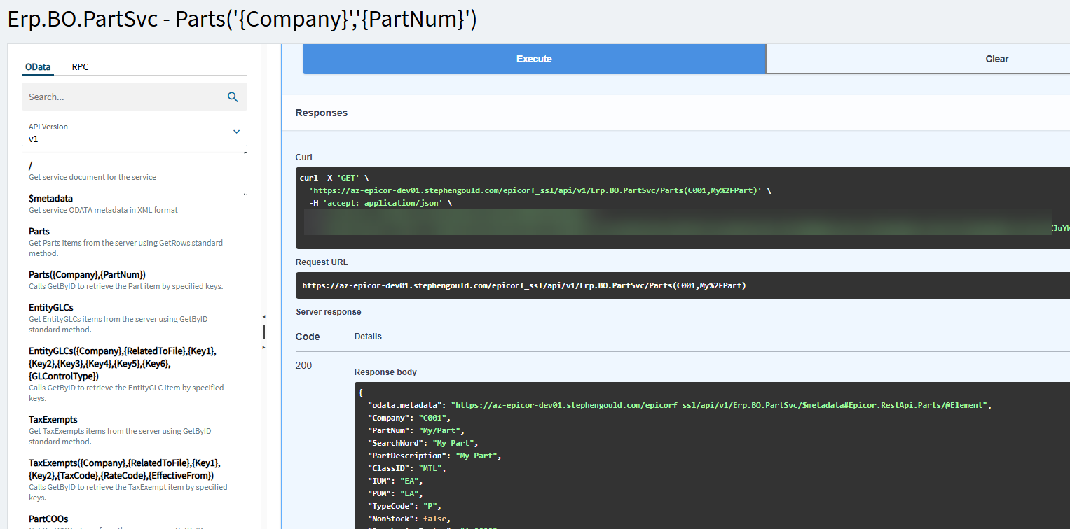

It works on WSL and Kestrel
