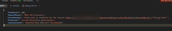

I’m still a bit confused why my live (windows) gave an error as well :thinking:
Your live Windows Error was I believe because the URLEncode didn’t work in that SWAGGER version. If you call it in POSTMan it works (at least it did for me)
I reported this on my Live (windows) instance. They updated the proxy in anticipation of the Linux move, and that’s what’s causing the issue. So it’s Linux related, but by association (this is my guess - not confirmed).
If you look at my screenshot the request URL looks properly encoded but not in the response body.
