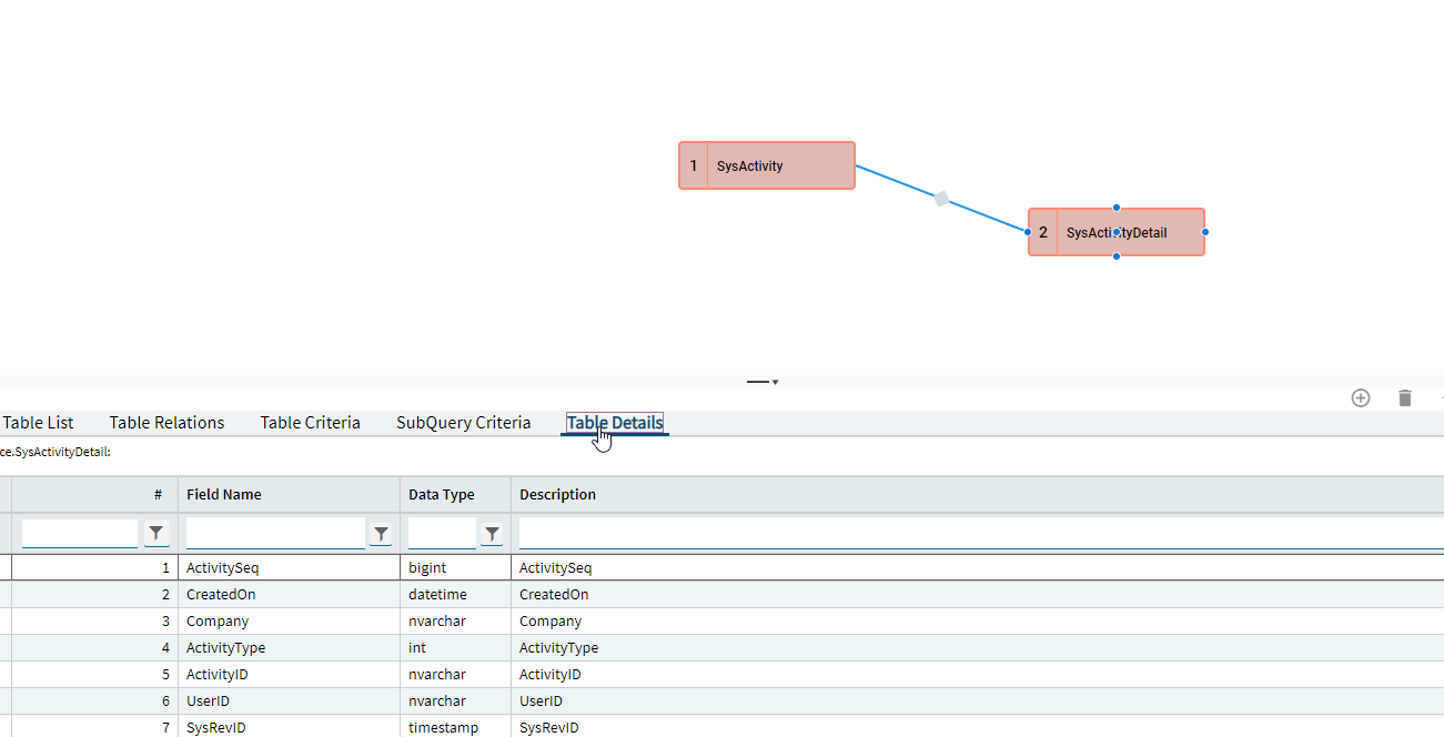

Activity tracking. With a BAQ you can pull exactly what screens they went into, which reports they ran, etc. I think its Ice.SysActivity and then there is a detail table that has the user ids.

How? What table is this in? SysActivityLog just shows Log on/off, Log on failure, and “Updated” - which just shows when activity log is enabled/disabled.

I think this got added in 2023.1 but not positive. It also has to be enabled.
Yup, I was hoping you would say that. I see it in our upgrade instance!
Thanks!

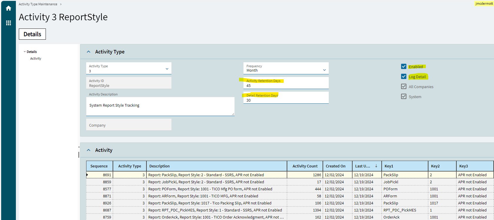

It seems I set them up, but not properly (for this need).
Here is what I think I’ll need for the future.
  • Enabled (duh)
  • Log detail (I had missed that)
  • And then how many days to record the info
Which by Murphy’s Law will be one week shorter than what I need when I actually need it.
Since I missed the “Log Detail” before today, it seems to only record the aggregate numbers and not… the details (like the user).

Correct. Now there is a major gotcha with this. The records in the primary activity table are one per calendar month per menu item and then all activity gets summed up on the record. So for example for Order Entry, there is a record for December, one for November, etc. When you lose that header record, you also seem to lose the detail that was tagged to it. So the retention period is not really accurate. I would set it for longer than that (I can’t because cloud customers don’t get to control these settings, and they refuse to go beyond the default). But realistically the settings in your screenshot do NOT give you a full month lookback as you might expect.
