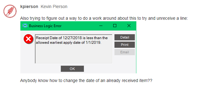

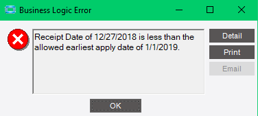

If using Earliest Allowed Apply dates, you might not be able to un-receive and re-receive with the same date as the original receipt. @kpierson ran into this.

+/- Mfg variance from jobs
