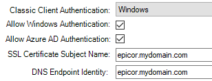

We also have a .local domain internally, but use a .com alias for our Epicor app server. This allowed us to use an SSL certificate from a valid CA instead of self-signed. Our internal DNS has a CNAME (Alias) record pointing to our app server.
So, we use epicor.domain.com instead of appserver.domain.local when accessing any Epicor resources.
On the app server setup, use the DNS Endpoint Identity to reference the .com domain.
