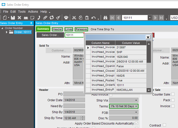

I’ve thrown together a simple BAQ from InvcHead. I’m using it as a BAQZone on the OrderNum. It shows accounting quick information about Invoices made to that Order without going to another screen.
10.1.500.26
When I go to an Order with a single Invoice, the result is ugly - labels are direct from the Query Phrase. For example InvcHead_InvoiceNum
When I go to an Order with more than one Invoice the results are much more pleasing:
But the same BAQ and BAQZone are showing me different results. That doesn’t make sense to me. I’m seeing if anyone has any insight.
I’d like them only to show the second way.

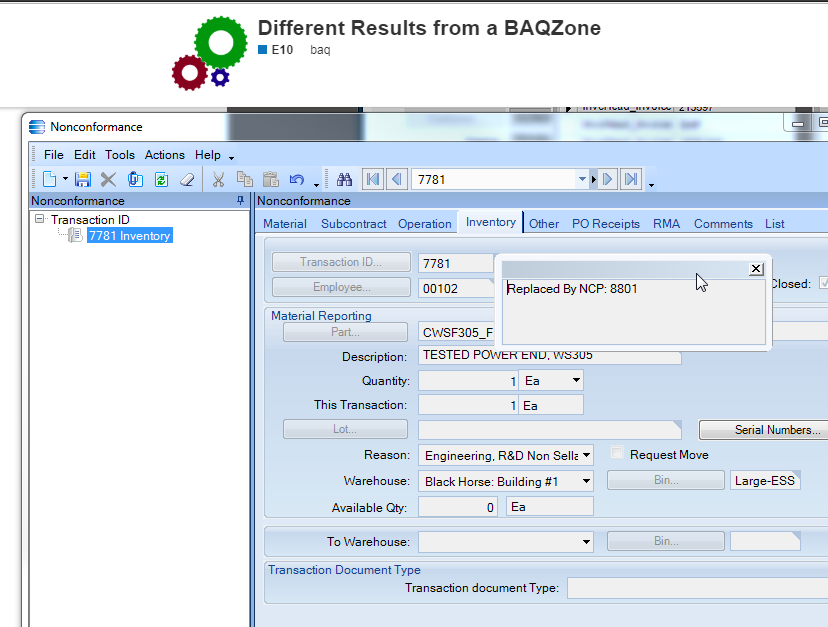

Ben, the BAQ Zone output has three possible formats, automatically selected. I’ve seen the question online before, how to force the multiple-record format for single-record, multiple field query outputs and have never seen anyone come up with a direct solution. Here’s an example of the single-field output format:
If no one is able to point you to a method to force the BAQ Zone format to be a specific one, I would recommend you craft your BAQ to allow for a “pro forma” record which will appear blank or show something benign like (end of list), always at the bottom of the list, but will always match your query. You may need two of them if your query could possibly return zero records. It’s not an optimal solution but it may be the only way.
You could also change from a BAQ Zone to an embedded grid, loaded by button click. But that’s not really in the scope of your question.
