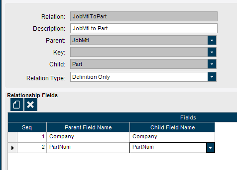

You are correct. It should be based on the JobMtl. In the RDD it looks like this:
I pasted in your code to my dataset definition, but still the field is not populating. I don’t get errors, just no value shown when it should at least show 0.00
You will have to replicate the same joins in the RDD for JobAsmbl to JobMtl.

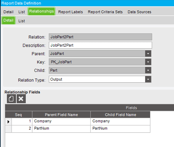

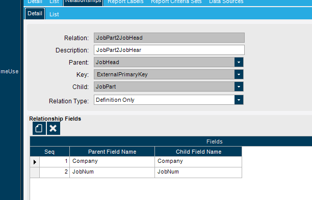

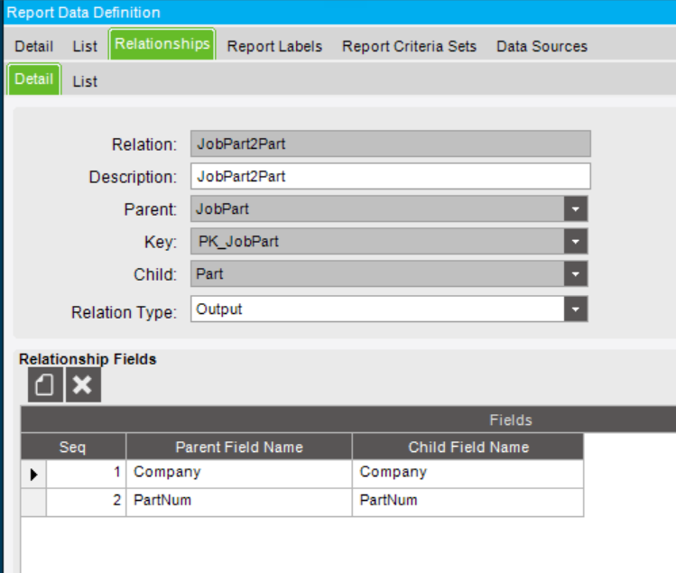

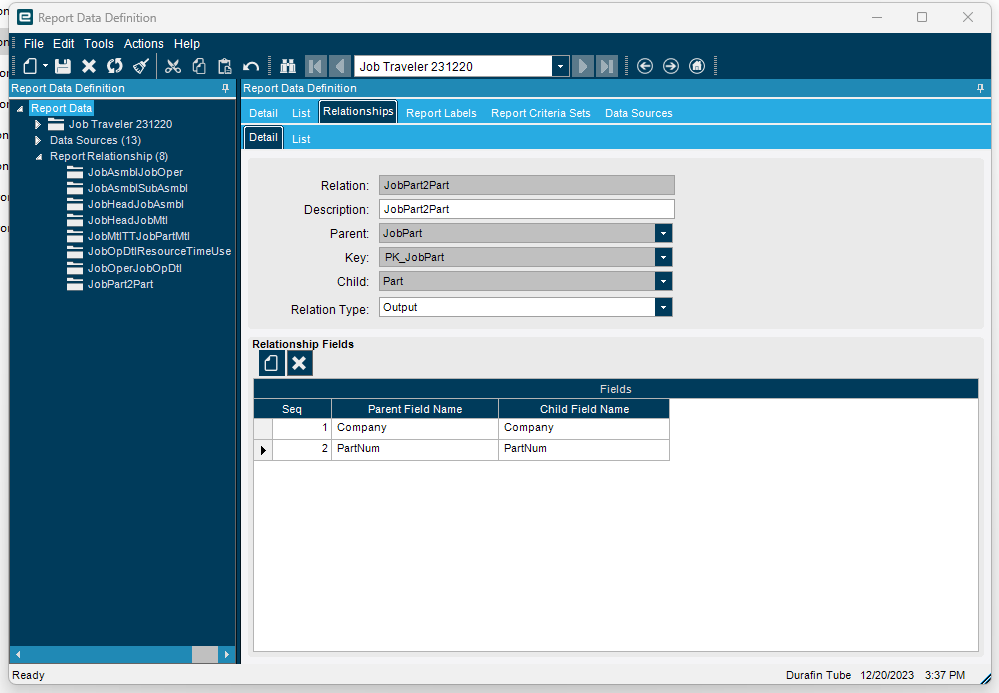

Deleted the JobMtl relationship and added this:
Since JobPart isn’t in a relationship, I added one:
and I changed the data definition to:

And success!!!
Thank you to all for your help on this. I greatly appreciate this.
Marking this as the solution since it has the final working code if anyone comes here in the future, but the solution was from Randy, John and others here. Thank you all for all the work you put in.

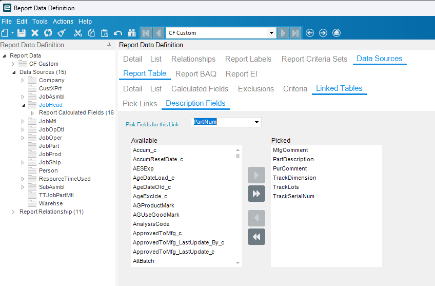

For the future, it’s possible to grab common links without setting up linkage. Using Linked Tables on the JobHead and picking the part number, you can add any field from the Part table, including user-defined.
Kinetic will create a name for the picked field that you use in the SSRS.
That looks amazing, but how do you call it out in the SSRS?
