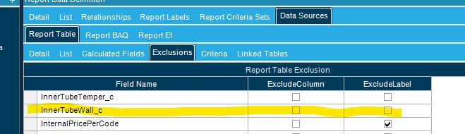

and I have added the field in the report:

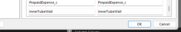

I then added the field onto the report itself:
=First(Fields!InnerTubeWall.Value, “JobHead”)
But when I print, I don’t get 0.00 or anything at all. Am I missing something or can someone point me in the direction of something that can lead me step by step through the process so I can see what it is I might be missing.
You need the “_c” when you added the field.
I had that originally until I changed the dataset definition to T12.[InnerTubeWall_c] as InnerTubeWall
I changed the field to InnerTubeWall_c:
I changed the field that prints to:
=First(Fields!InnerTubeWall_c.Value, “JobHead”)
and changed T12.[InnerTubeWall_c] as InnerTubeWall to T12.[InnerTubeWall_c] as InnerTubeWall_c
Same result. Blank field.
Changed T12[InnerTubeWall_c} as InnerTubeWall_c to just T12[InnerTubeWall_c]

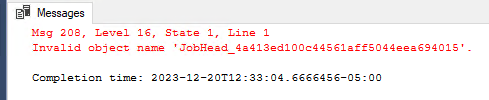

Todd, when you query the reporting database for that table using SSMS or something else…
SELECT *
FROM JobHead_YOURGUID
Do you see your field in that dataset?
So run your report with archive period set to 1 day. Then run that query above on the database that holds your reporting data for your reports.
Might be a dumb question, but where do I find YOURGUID? It’s being populated in my query by Parameters!TableGuid.Value but I’m guessing I need to havethat actual value
When you run the report, set the archive to a day and then you can get the GUID in the system monitor.

I believe I found the GUID nosing around in SSMS. Now if I run the Select * I get a result of 1 row. But that field shows in the Part table, not the JobHead table. In the Dataset in SSRS, it is the JobHead dataset.
