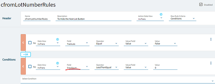

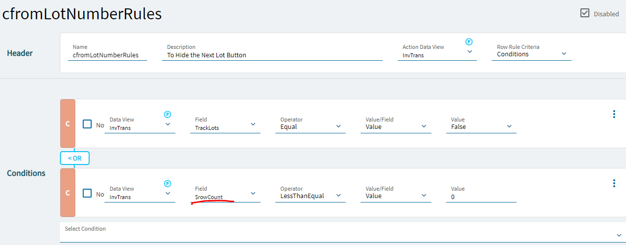

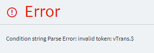

I manage to copy the Next Lot button but the DataRules FromLotNumberRules that hides the standard button that I also copied to set to hide my custom button is causing an error. Have you ever seen this error before?
To my understanding it seems to be caused by $rowCount in the condition field.
I figured out what the additional condition does, its to hide the button for when you first open the Inventory Transfer page. I manage to work around it using the PartNum as empty to hide the button.
