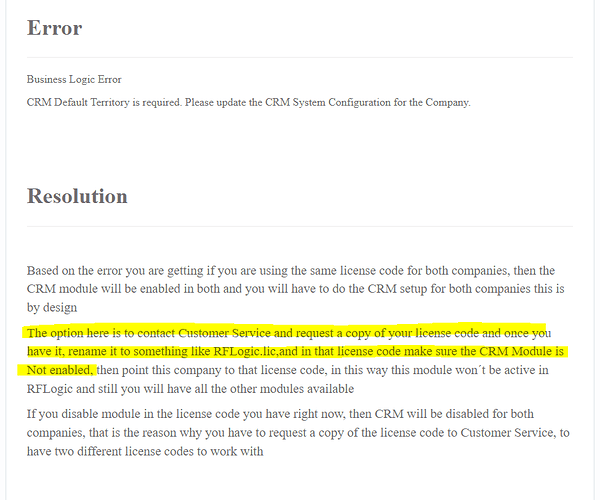

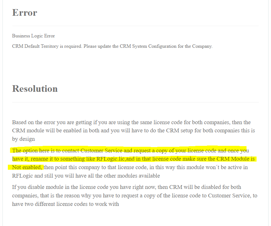

I know this is old by found this article on Epicare: Unable to Have a CRM Setup For Only One Company KB0107250
