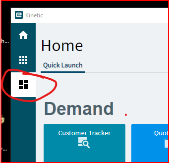

Disable Specific EDD user Icon on Active Home page
Is there any way to disable the EDD ICON on the Kinetic Active home page for specific users? We have searched in User Security Settings and cannot find any settings that keep this Icon from showing up.
We have opened up EDD settings and deleted access for specific users but every time they click on the EDD Icon in Kinetic there access for EDD shows up as view again. Are we missing settings somewhere for this?
