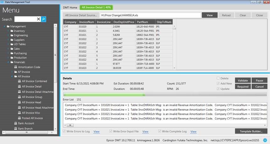

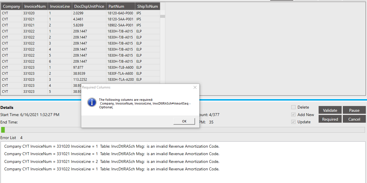

Hello, We have recently upgraded from 10.2.4 to 10.2.7 and now we are having issues with the DMT. It’s making us do this amortization code now.
Is there a way I can just bypass this and proceed how we have been doing it this whole time?

Seems like it’s a bug with the DMT wanting the invdtlrasch to be required when it’s not suppose to be

Right, it works fine if you do it manually but using DMT throws this error.
I know. I hate it.
Just make sure it’s not a red herring. You know, on the off chance you have something that does, in fact, now automatically amortize.
Or, is the seq actually zero in Invoice Entry, or something like that?
