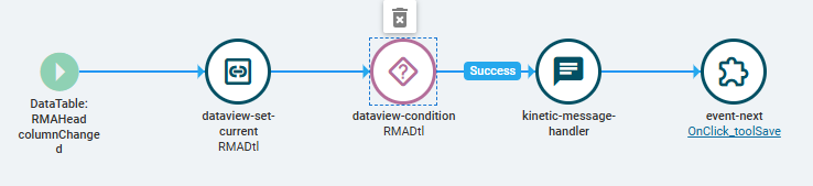

I’m in the process of using a dataview-condition widget to iterate over multiple rows in my RMADtl Grid. I am updating the values of RMADtl.ShortChar02 with the value {RMAHead.ShortChar06}.
This process works fine and appears to be saving the new data appropriately.
My issue is that the lines disappear upon a refresh, specifically Kinetic’s refresh button. Once the Kinetic refresh button is clicked, the lines disappear from the RMADtl grid, they reappear on a browser refresh with the updates applied as I expected.
I also noticed the line becomes both open and closed if I take a look at the sub-page before refreshing.
Any ideas?
I would do this with a function and then just get the dataset again afterwards.
