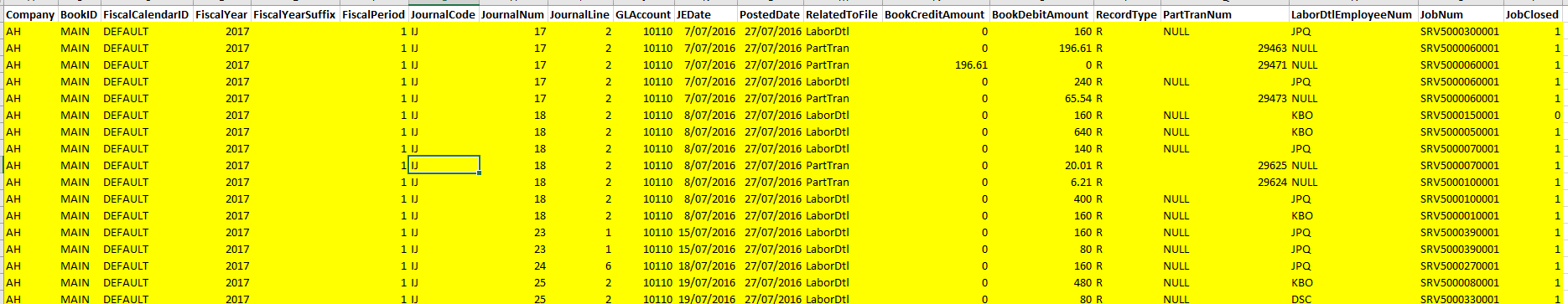

I am trying to find a way to pull up the GL transactions based on Job number that I can reconcile to what is still open on the WIP report.
As per below we are $10,039.36 more on our GL for the end of July.
GL account closing balance $79,639.66
Work in Process WIP balance $69,600.30
I have attached the selections I make on the Work in Process report.

We have had the issue since the system was implemented July '16 however we were able to reconcile the accounts with the help of a BAQ for the first few months which we don’t have access to anymore.
I’m not competent in BAQ’s and was wondering if someone could assist to replicate a BAQ that splits the GL transactions per job rather than periodic posting?
