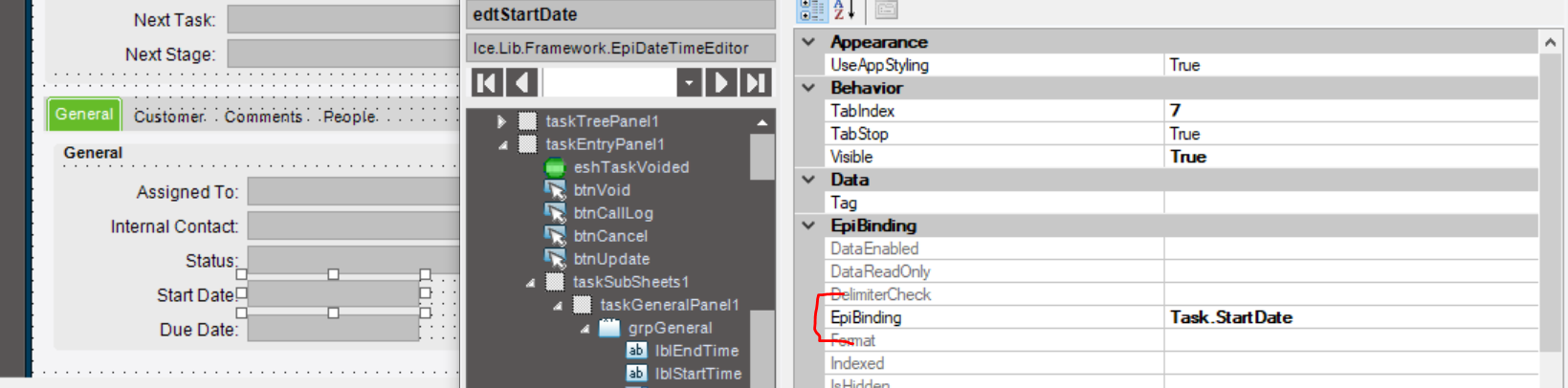

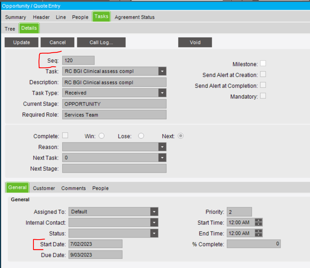

I am utilising the SLS and need to display a column in a customised dashboard based on two fields in the opportunity/quote entry form inside the tasks tab. Essentially these fields are manually input as tasks to be completed for the opportunity/client.
The column will be titled “Date of Last Contact” and has to pull from these two below values highlighted. The logic I want is as follows: Display the “Start Date” only if the “Seq Num” is = ‘120’
For context there are a bunch of tasks that all have different sequence numbers, All I need is the seq num that equals ‘120’.

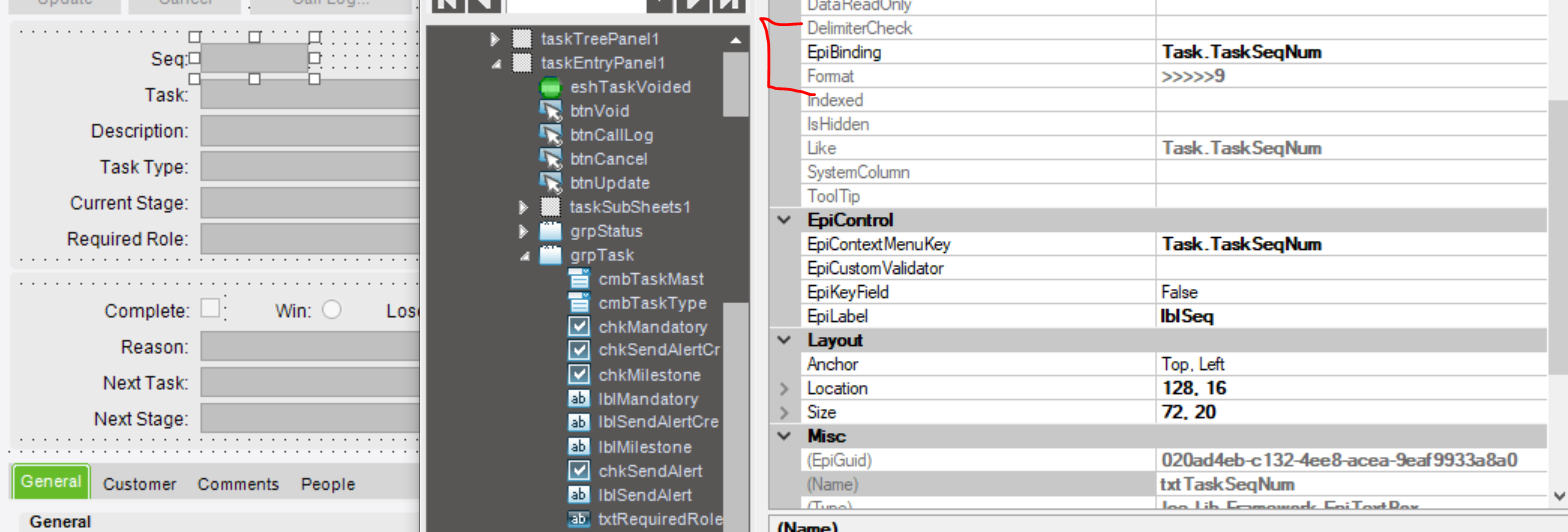

These are the bindings for each field:
The dashboard is using a BAQ. I am wondering what the best approach would be to display this column, it’s simple to display these two fields in the BAQ separately however would I need a calculated value that stipulates if the Task.TaskSeqNum = ‘120’ then display Task.StartDate?
