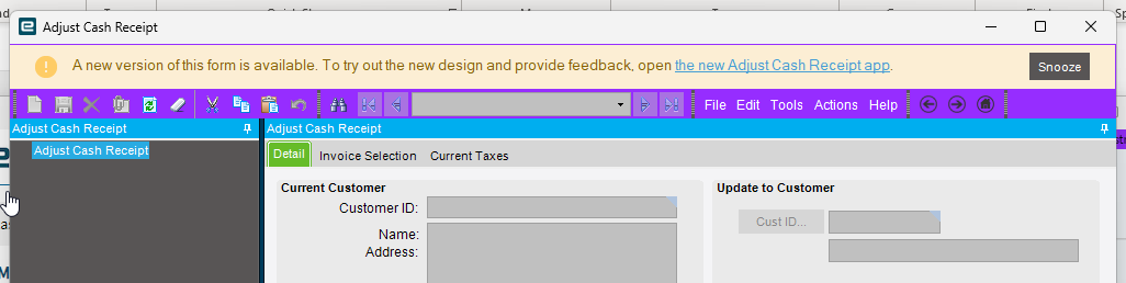

How can I restore the link in a classic window to access your Kinetic version?

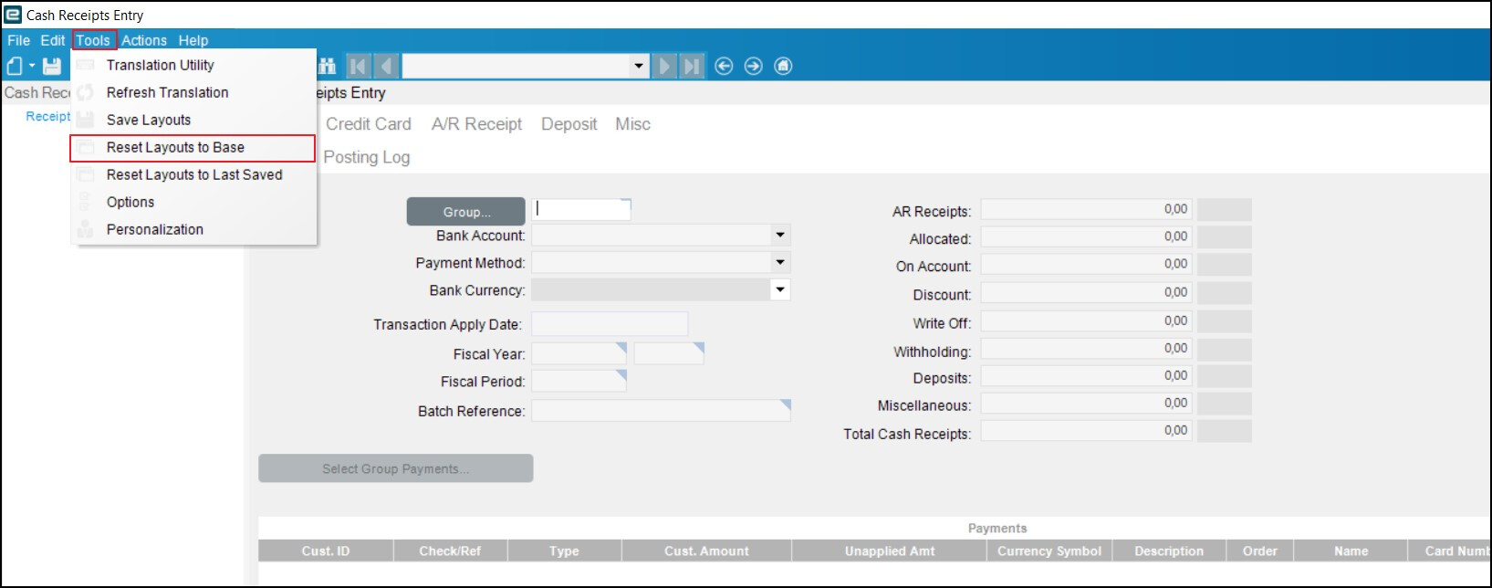

I believe if you purge personalizations you can get it back.

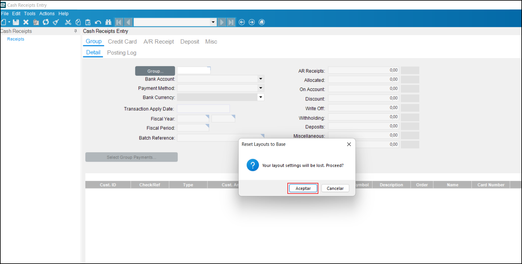

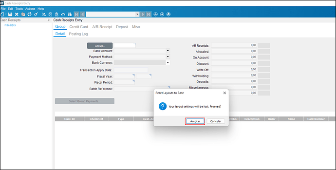

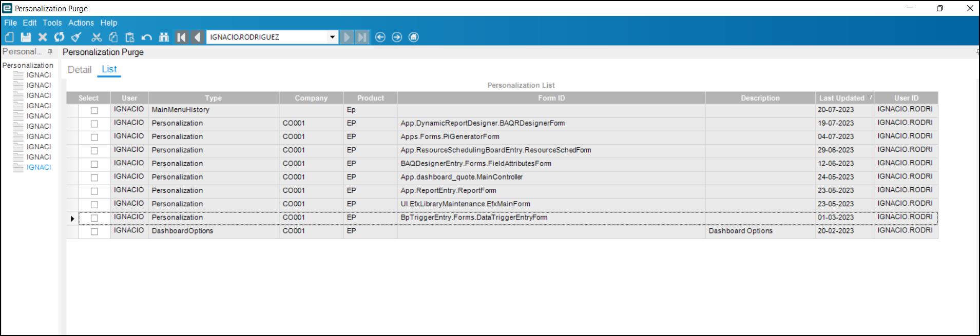

The reset layouts to base is performed and the problem continues.

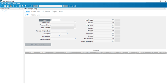

I meant this screen. It’s likely one of these checked 3
I deleted the records that appeared with today’s date, but the link still does not appear.
Hmmm it must be in personalization layers somewhere because if you click it while in developer mode it wants to save a customization layer.

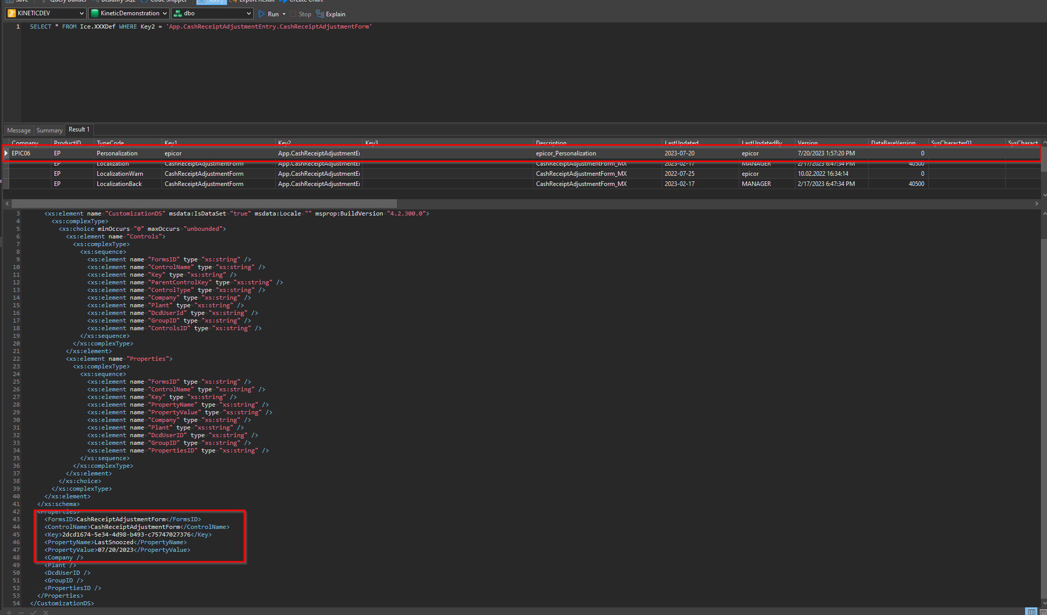

This is what it shows me in developer mode:
Deleting the personalization was the solution back in the 10.2.700 days. Not sure how it’s changed after 4 version of kinetic changes:
Here is the trace

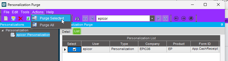

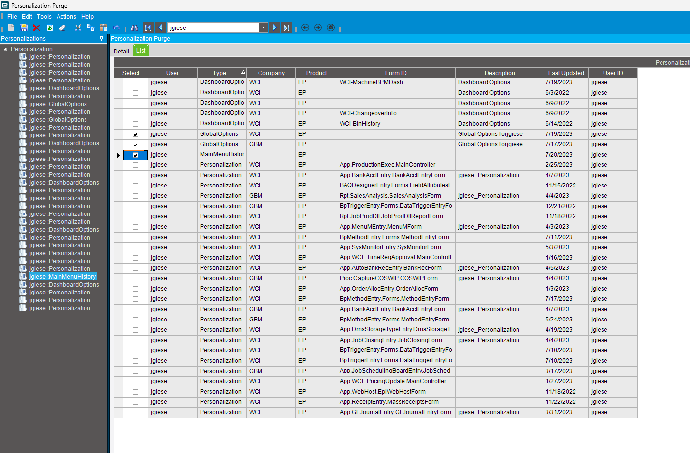

It’s maintained as a personalization as stated
When I purged the entire personalization I got the bar back.
But you have to clear cache
Problem solved, thank you very much.
