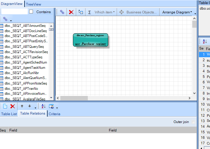

Sorry, it is base table, not UD table…and actually i picked data which i needed from different tables and dumped to this table(which and only table ,that i am using in BAQ)…which ready to display in Dashboard. But problem is,there are so many duplicate records…I cannot distinguish them in BAQ and how i can filter them ? Because ,there is not inbuilt functionality to avoid displaying duplicate records…

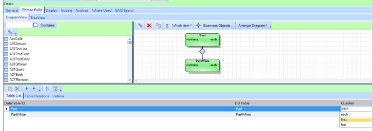

Which tables are you using for the BAQ? Generally, tables have field like seqnum, linenum…to separate the records.
If not that then on the BAQ, there is “table list” tab at the lower left side, there on the qualifier you can select may be first or last option instead of each option. hope that helps.

@speaktobinita : This table is appearing in blue color, what is it mean? I can’t select qualifier as first… because it has not any reletion…

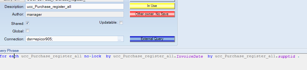

@John_Mitchell : yes, it is an external query, but now i am confused,because, if it is a View, why it is showing in SQL server’s Table list. another thing…How i can apply ‘DISTINCT’ to an external query. Because this setup is new to me.
Thanks…
It seems to be an external query. If it is a SQL view then you need to pull distinct data in the view itself. You can’t apply distinct on the external BAQ.
Yes Binita,
i have already selected DISTINCT records in View design. Still,distinct records are not displayed .
