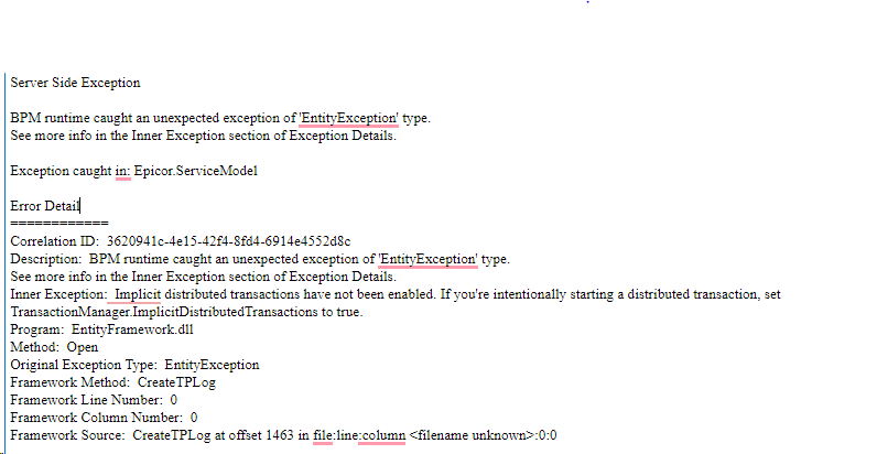

However, during testing, we encountered runtime errors related to distributed transactions, including:
- “Implicit distributed transactions have not been enabled.” with the recommendation to set
TransactionManager.ImplicitDistributedTransactionsto “true.”

Despite these efforts, we are still encountering the following errors:
- The distributed transaction error persists.
