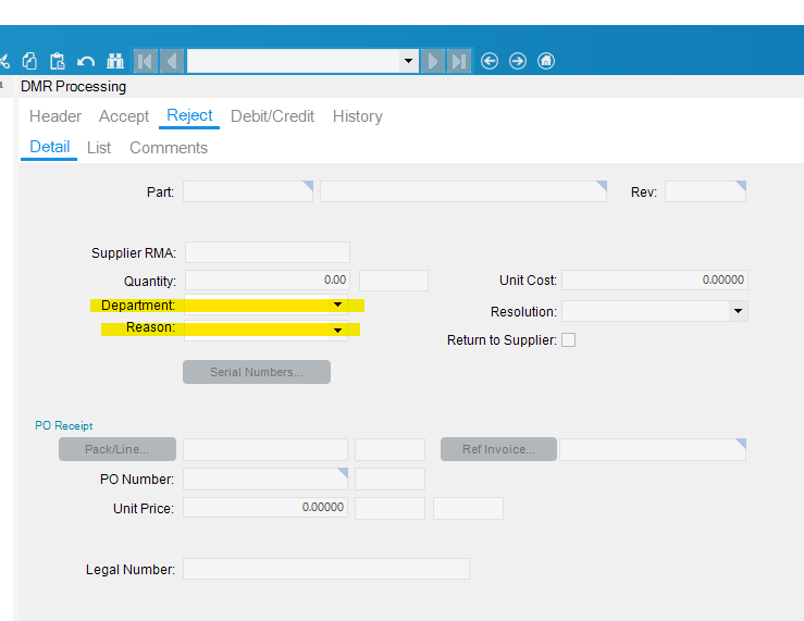

I am attempting to customize the DMR Processing Screen. Under the Reject > Detail screen, our users want the Reject Reason Drop down to be filtered based on a UD field called “Department” in order to make finding a specific reason code a little easier.
I have currently built the following in order to attempt to create this. I am using UD10 as a “master table” for all the departments and the reject reason codes they are linked to. I am only using 3 columns to do this: Key1, Character01 (for the department), and Character02 (for the reason code). Here are a couple of sample records for reference:
Key1: 100, Character01: “Igniters/Recips”, Character02: “Damaged”
Key1: 107, Character01: “Igniters/Recips”, Character02: “Crack: Counterbore”
Key1: 135, Character01: “Power Supplies”, Character02: “Transformer: Failure”
On the DMR Processing > Reject > Detail sheet, I have hidden the default “Reason” field and replaced it with two custom epiUltraCombo boxes: “Department” and “Reason”.
I populate the first field (Department) programmatically when the sheet loads with each unique department listed in the UD10 table. This works without issue.
What I would like to do is capture the “RowSelected” event when a user selects a department in the first dropdown (according to Infragistics - this should be an event I can utilize unless I’m misunderstanding the documentation: RowSelected Event (UltraCombo) - Infragistics Windows Forms™ Help), and use the selected department to populate the second dropdown (reason) with only the reason codes linked to the selected department. So using the sample data above, if a user selects “Igniters/Recips” as the department, “Damaged”, and “Crack: Counterbore” should be the only records that display in the dropdown.

This code compiles with no issue within the script editor and I receive no runtime errors. However, the event never actually appears to be called as I never see the messagebox.
My question is two fold:
  1. While my syntax appears to be at least correct, what am I doing wrong that is causing the event not to fire?
  2. If there are any criticisms with how I’ve attempted to approach this, please feel free to share. I’m here to learn, and if there’s a better way to go about this I would very much love to be told.
Thanks everyone!
