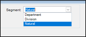

Try using one of these for the “SegmentNbrName” on the import.
Natural
Department
Division

I have run into situations like this and found I have had to get creative. Here are a couple of creative thoughts. I don’t see the field, SegmentNbrName, in the table, COASegValues so the DMT may be giving you incorrect information which it has been known to do. I would try using the field, SegmentNbr instead which is an Epicor generated field in the COASegment table. You could also try the SegmentNbr and include the SegmentNbrName but as a blank field. As I said you may need to be creative.
Thank you! this solution did the trick. ![]()
