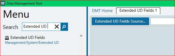

What is the module you using for it?
I used this and no issues.
same one. I am on Kinetic 2024.2.4
