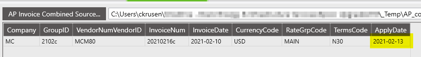

Has anyone had success at DMT’ing AP Invoices and having the apply date NOT be today? I’m using AP Invoice Combined, and no matter what is in my load, it’ll set the Apply Date to today (2/15/2021 in this case. It’d be nice if I didn’t have to change it in Invoice Entry.

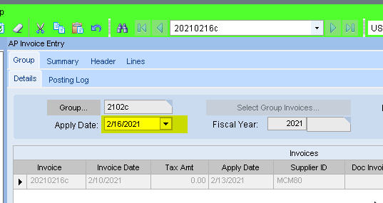

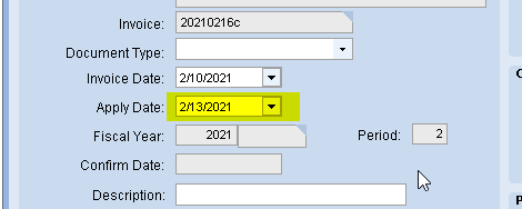

In a nut shell … A new group created by DMT will have todays date for the APInvGrp.ApplyDate. But the individual invoices will use the ApplyDate column from DMT
