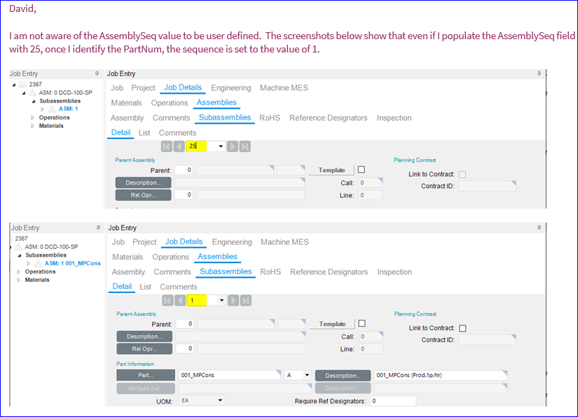

I had contacted Epicor DMT guru at the time (David Hogue) with that exact question… below is what I received from our emails back and forth:
My question is on the AssemblySeq values and whether they can be “user assigned” as the DMT description states.
Like Epicor… Assembly 000 is the top-most level.
However, the assembly sequences in our legacy system are not sequential…
Assembly 001 is the first assembly (ParentAssemblySeq = 0)
Assembly 022 is the next assembly (ParentAssemblySeq = 0)
Assembly 024 is the next assembly (ParentAssemblySeq = 0)
Assembly 116 is the next assembly (ParentAssemblySeq = 0)
Etc.
~~ Response ~~
So, based on that… I think the DMT “description” is just plain wrong and it is not possible.
If it is critical to maintain the assembly sequence numbers you have, then you can potentially inject placeholder assemblies (to eat up the sequential numbers) and then delete them in a subsequent DMT pass. I didn’t try this, so I can’t attest to whether that would work, but in theory, it should.
