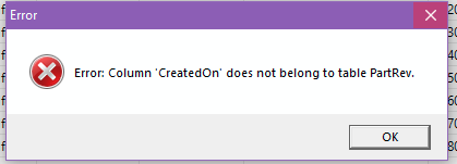

Im trying to update about 1500 operations so im starting with a simple upload of 7. Im using Bill of Operations in DMT and ill share a screenshot of my fields below. i noticed that i have a single operation already on my part so i planned on removing it and then uploading my changes. Whenever i run the single line removal i get the error below. For the hell of it, i tried to upload my operation changes (different sequencing so it would just add on at the bottom) but that gave me the same error. I closed out of DMT, restarted the task manager, and even made a new csv file with the test info but i still get it. I have never gotten this error in the past so im either doing something terribly wrong or something is acting up on my server side.

yea not surprised they keep breaking it with their updates. We went from 10.0 to 10.1 about 6-7 years ago and i believe our dmt is the proper version since the last time ive done a BOO update it worked fine on this DMT version and 10.1… I contacted epicor support so if they actually help out ill post my update but ill leave this open until something changes.
